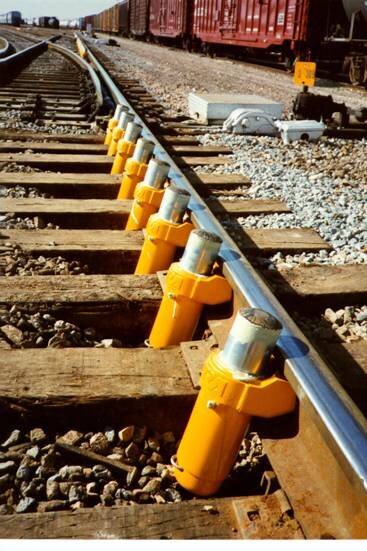

I recall being taken on a visit to Toton in my youth and watching the retarders at work. Seriously skilled work on the part of the operators in the tower.

The technical name for the system fitted in 1950s marshalling yards to slow hump shunted wagons as they went into the fans was retarders.
