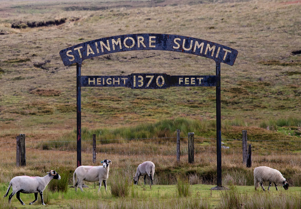

Some major summits have/had summit boards giving the altitude, but I suspect there were there for passengers looking out of the window not for operational reasons. Some of the most important are now in the custody of the National Railway Museum, with replicas on site.
Here are some examples:
