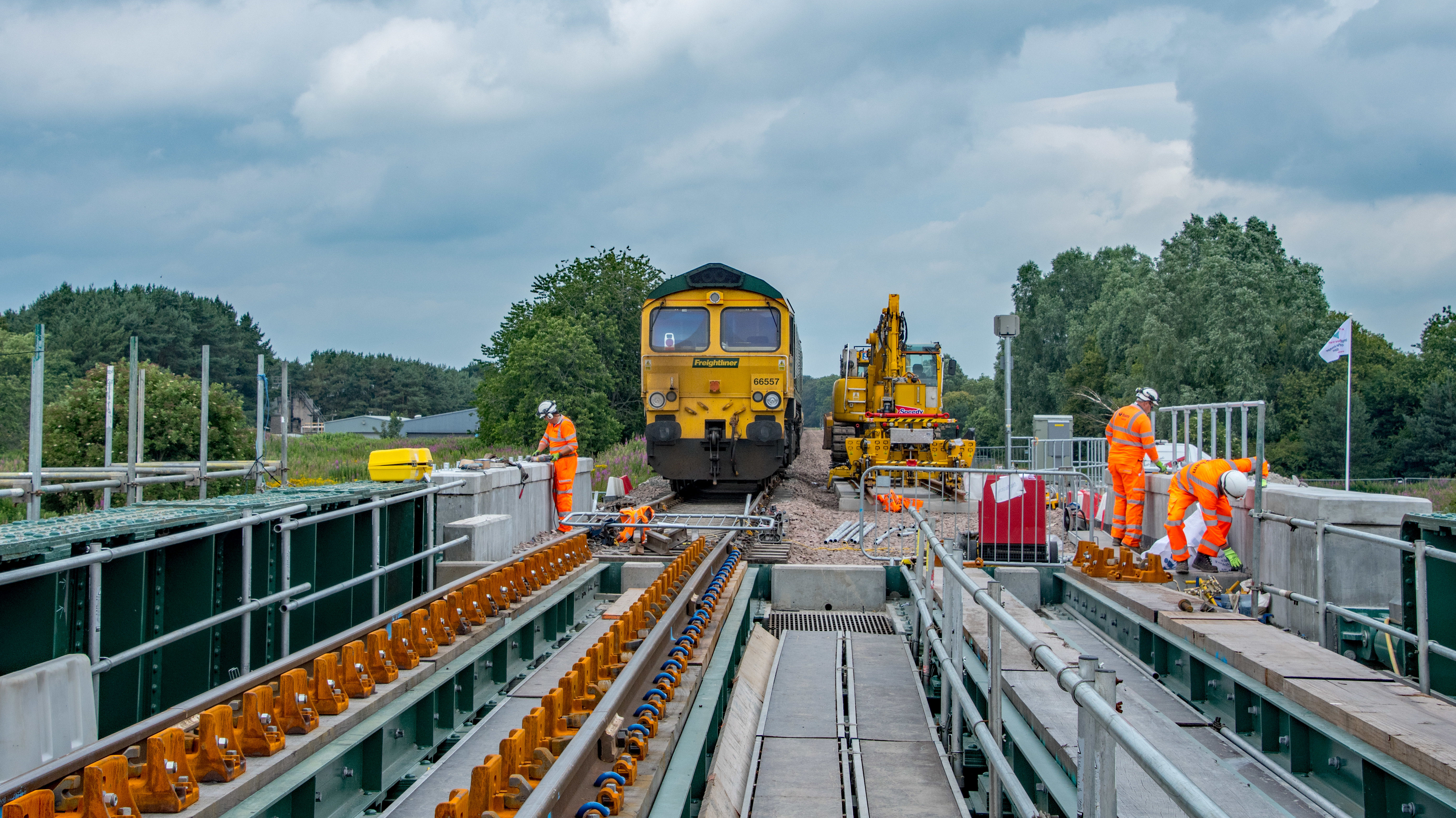

Interesting article on what's been done as 'Phase 1'
Journey time over the 173-kilometre-long Aberdeen and Inverness route is around 2 ¼ hours with an irregular, about two-hourly service frequency.
Whilst the Scottish Government’s long-term objective for the Aberdeen to Inverness line is the provision of an hourly service with a two-hour journey time,
It has taken four years to deliver A2I phase one – one of the UK’s longest redoubling projects – as well as a series of enhancements to provide more-efficient loop operation. On a single-track railway, this is perhaps likely to offer greater time savings than line speed enhancements.
