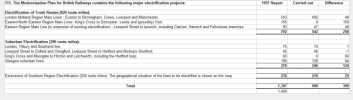

Was there much dropped in Glasgow? I saw that in one of the electrification reports it has more route miles planned in 1957 then were actually built. Does anyone have any idea on what was dropped there?
  • East Coast Electrics-An Alternative British Railway  Page 3  alternatehistory.com.png
The exile
31 Mar 2010
9,390
Somerset
Depending on whether “carried out” means “up to and including the 1974 scheme” or “ever”, Carstairs to Edinburgh would account for a hefty chunk of those miles.

That seems to be a shot from an ‘alternative history’. Does it have any genuine historical merit?
eldomtom2
6 Oct 2018
2,383
It is a screenshot from a thread on an alternate history forum, but the post is discussing what happened in the real world:
It cites the 33-Year Plan of 1957 and British Railways Engineering 1948-80 by John Johnson as its sources.

It seems to be from a 1957 report on electrification and the routes all the routes shown with all the routes shown actually being considered for electrification in real life so I don't think its alternate history. Maybe the 60 miles left out was the Inverclyde Line which wasn't electrified until 1967?
Having had the chance to look at this in a bit more detail, I think that there was a lot of fudging and hedging of bets when it came to suburban electrification in Glasgow as mentioned in the 1955 Modernisation Plan. Although the Plan did mention an approximate route mileage of 190 this came with an important footnote:
"The figures quoted for the Glasgow suburban lines are based on the Inglis Report of 1951 on Passenger Transport in Glasgow & District. The adoption, scope and staging of the scheme are dependent upon further study and discussion with the Glasgow Corporation regarding future co-ordiation of road and rail services in the area." I read that as "It's anybody's guess."
Sir Robert Inglis was an ex-railwayman (L&NER) and had chaired BTC's Glasgow & District Transport Committee, established in 1949. This had four other ex-railwaymen on it, one an electrical engineer, and just one 'bus man', from Scottish Omnibuses (also a former railwayman). The BTC had, of course taken over the SMT bus operations in 1949. Glasgow Corporation, which ran buses, trams, the Glasgow Subway and an emerging network of trolleybuses (the electric modes all powered from the Corporations own power station, which had escaped nationalisation) had virtually no involvement.
Surprise, surprise, the Inglis Report was all about railways and in particular electrification. This would extend over a massive 309 miles, extending as far as Ayr and Lennoxtown via Kirkintilloch. Closer to Glasgow it would even include the likes of Renrew Wharf, the Govan Branch, Princes Pier via Kilmacolm, Bothwell and Beith via Lugton! Bizarrely, one of the few routes that wasn't included was the WCML. Motherwell was variously reached via Kirkhill and the Hamilton Circle or what we think of the as the Argyle Line and Bellshill. Amazingly this was estimated at only £13.5 million for the physical work!
The plan was seen to be deliverable in three phases. The first of these was for what we think of as the North Electrics, Cathcart and South Side lines, the Gourock/Wemyss Bay line but a few bells and whistles like the Northern Circle via Maryhill, Govan, Renfrew, East Kilbride, Paisley West and Bothwell.
After publication of the Modernisation Plan the first sections, just part of Inglis' proposals, saw work start in 1957 - basically the North Electrics (Helensburgh/Balloch/Milngavie-Springburn/Airdrie/Bridgton) and South Electrics (Cathcart/Neilston/Kirkhill). Ironically the South Electrics had to extend beyond Kirkhill to Newton and then Motherwell via the WCML through Douglas Park in order to tie in with a second grid feeder station. These bits alone consumed around £13.5 million of the total Modernisation Plan 'Glasgow' budget of only £18 million.
Not for the first time did electrification turn out to be a total financial disaster in terms of running out of money with only a small proportion of initial expectations met. Much more might be said but not really about the WCML. Perhaps a thread of its own one day?
