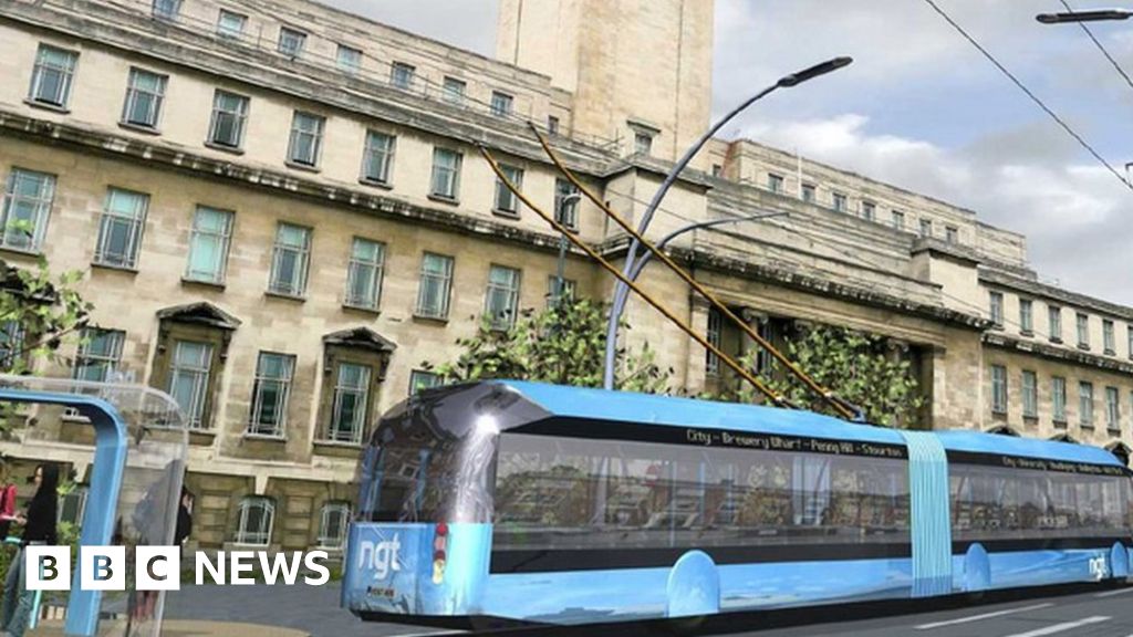

Look at Leeds and how for last 8 or so years there been nonstop battles.
Plans to build a £250m trolley bus network in Leeds have been rejected by the government.
The Department for Transport (DfT) accepted a report from a planning inspector who said the scheme was "not in the public interest".
Councillor Judith Blake said the city had been "let down" by the decision.
The DfT said its £173m contribution towards the project would be used on other public transport schemes in the city.
