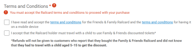

I bought a new F&F railcard last week. It's stated a number of times at the point of purchase that you have to have a child with you. You even have to tick a specific box to acknowledge this.
Image of F&F terms and conditions:
I accept that the Railcard holder must travel with a child to use Family & Friends discounted tickets*
*Refunds will not be given to customers who report that they bought the Family & Friends Railcard and did not know that they had to travel with a child aged 5-15 to get the discount.
Given the purpose of the card and the clarity of these notices at the point of purchase, I think it may be difficult to to put a persuasive argument together that you were unaware of the conditions; especially as you've then found that you cannot apply the F&F railcard at the machine to a booking that doesn't include a child, so you've selected network railcard instead.
Nevertheless, following the advice from the experts you will hopefully get a satisfactory resolution.
