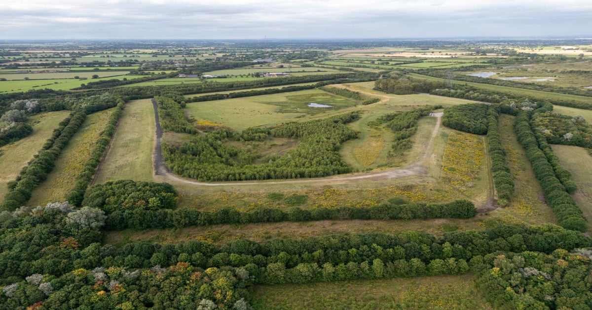

In other news, the UK‘s largest (to date) Battery storage system is now fully funded, with construction to start imminently for commissioning in mid 2027.
And it is certainly needed. Right now the wholesale spot price for electricity is -£20/MWh, when demand is almost 34GW.
Battery energy storage system (BESS) developer Fidra Energy has announced it has received up to £445 million in new equity investment to fund the Thorpe Marsh BESS.
Funding comes from institutional investor EIG, which launched Fidra Energy in October of last year, and the UK’s National Wealth Fund (NWF). With this, Fidra Energy has reached financial close on its Thorpe Marsh BESS project, located in Doncaster, South Yorkshire.
The Thorpe Marsh BESS is a 1.4GW/3.1GWh project which, once completed, will be the UK’s largest BESS and one of the largest in Europe. Construction is set to begin imminently, and the site is expected to be operational from mid-2027.
