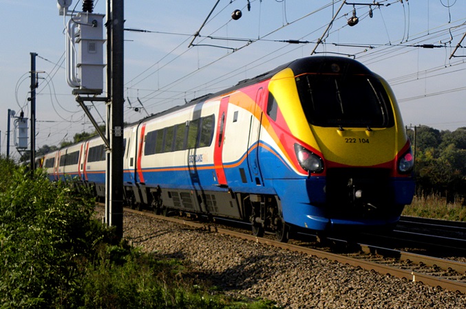

It *could* arc.
Look at this Meridian. See the thin orange line, running across above the windscreen and just below the roof line? That is the 'safe' distance from OHLE. Below that line, it is very, very unlikely to arc. Above it, it is the exact opposite.

It *could* arc.
[url]http://www.uraken.net/world/wrail/eng/class222/[/url]. Above it, it is the exact opposite.[/QUOTE]
I think you mean "Above it, it gets more likely the closer you approach it." Lots of factors involved, like how well you are earthed for a start, even atmospheric humidity.
