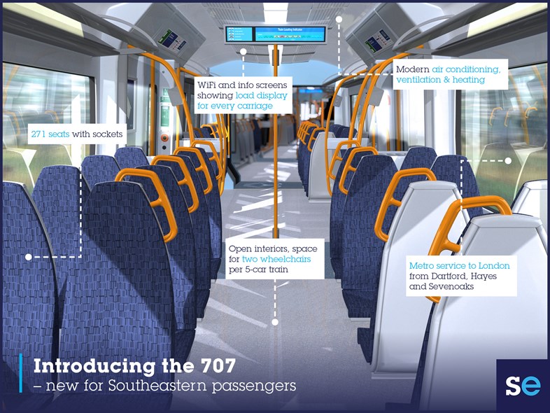

On Southeastern you can make a direct comparison between 3 completely different commuter trains, all 20m units so a roughly similar width.
The 707s have a massive aisle and narrow seats with no shoulder spacing, resulting in people overhanging the aisle. That is entirely down to the seating layout.
The 376s also have 2+2 seating, but more comfortably spaced, so the aisle is narrower, but still wide enough for decent standing capacity.
The 465/466s have 3+2 seating, so have a narrow aisle. The middle seats ARE used in the rush hour.
Taking two pictures from the Southeastern website, and a Wikipedia 466 image.
Class 707, showing the massive aisle, and seats with no spacing
Class 376, showing the smaller but still wide aisle, and better spacing between the seats.
Wikipedia image of a 466 showing the narrower aisle
