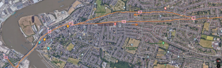

Here's my full idea. It's quite long so hesitated to post the 'detailed ' version.
Phase 1
Phase 1 is intended as a fast-to-implement route with high speeds to compete with blue bell hill or other routes for road drivers between Maidstone and Medway. It also gives fast connection to Chatham Docks and links to existing major stations at Strood and Gillingham in north, and uses the maidstone town centre dual carriageway loop for a wide catchment in the south. P&R could be added at Aylesford and where the railway passes under the M2.
Phase 1 key route is the existing railway from Strood to Maidstone via Snodland. That takes 24 minutes currently and has spare capacity. In future perhaps some passing loops at stations could be added to avoid less popular stations, noting some trains on this route go all the way to st pancras
Phase 2: Maidstone end would be a loop around the town centre. Maidstone west station to be slightly north (or new tram-only platforms connecting to existing station), between A20 and Buckland Road. Note this triangle of land also bounded by st peter's street could be redeveloped for mixed uses, as well as other ground-level car parks nearby, to help fund the system. The major roads around the town centre cut it off from the other areas. Radial bus routes into maidstone from the south and east would be able to connect to the new tram-train route without entering the centre itself. The line from Maidstone East also appears lightly-used enough to allow trams to run there before reconnecting near Maidstone Barracks.
3. From Strood, there should be a station somewhere in Medway City Estate. Keeping on periphery reduces the time penalty from going deeper into it. Obviously some trade off there.
a. Medway tunnel looks wide and tall enough to accomodate overhead wires and avoid need to battery-hybrid trams.
b. 3 stations at near Chatham docks are actually ~600m spaced, with is a good distance from a tram route. Note I am not proposing for it to go into Chatham itself. That is because this route is targeting slightly longer-distance travellers so speed is of the essence to compete with cars, and sticking to mostly dual carriageway reduces cost. There's nothing to stop this in future.
c. From Pier road there is a former railway alignment (some still with single track sections) parallel to Rosebery road which could be used to connect to Gillingham station. Admittedly that is pretty overgrown with trees but if there were enough objections then maybe it could be a (costly) cut and cover with new pedestrian/cycle path above the tram route.
d. Note the land to north and east of the existing station is mostly carpark, perfect for development and gives some choice on tram route to the station (or if a loop is needed to avoid need for double-ended trams).
e. That is the end of Phase 1! There are connections to existing railway at Strood and Gillingham. I don't think there is capacity for tram-trains to run between Strood and Gillingham via Rochester and Chatham.
(as an aside, I love the idea of a cable car from Rochester station to the southern end of Medway City estate, which could be redeveloped along the southern riverfront while keeping the industrial businesses in the middle. There could be a 3rd station/stop in The Historic Dockyard. This kind of obstacle with existing quality rail transport is the perfect situation for a cable car to be successful, serving tourists, students, and commuters. Anyway, back to the trams!)
Phase 2
Phase 2 is basically the P&R loop (for M2) making very little use of existing railway alignment. Its purpose to reduce the number of private vehicles entering into the town centres, and should be built with transit-oriented-development in mind, particularly making use of existing car parks. The eastern section (via gillingham business park) is much more straightforward than the Western (blue bell to rochester) end. An alternative could be following the A2 straight through the towncentres, but that does less to keep drivers from driving into Medway and is more duplicative of existing railway. A2 could either be a future phase or a well-connected bus route.
1. Phase 2 either starts at Gillingham station if there is capacity to run part-way to Rainham on existing rail alignment (noting some london services terminate at gillingham). If not then it would branch off from Phase 1 at the Pier Road Asda and follow the dual carriage way around to a station near corner of Yokosuka way and beechings way.
a. station near Gillingham business park, which is big enough that could even warrant have 2 stations at either end!
b. then on intermediate station before serving a P&R off the M2.
2. The next section follows the M2 to Blue bell hill, where there would be another P&R. The M2 median is wide enough to support an elevated bit of track, but I don't know if that would be any cheaper than cutting down some trees, and an intermediate stop at Lordswood would also be useful. Same logic for the P&R in Blue Bell Hill on south side of M2 - going over/under the motorway twice might be more cost than benefit vs staying on north side.
3. The route then follows the A229 into Rochester town centre. A portion of this could be split directionally with St williams way (see arrows below), or just one of those given over more fully to the tram priority (maybe access only?). THere are some greenfields and highway verges to help.
      a. one stop at southern end of rochester high street, and another near the existing station. Note the surface-level car parks should be removed given the P&R opportunities, this allows for transport-oriented development and improves speed + competitiveness of the tram route.
      b. The line shows a crossing on the historic rochester bridge. Perhaps that isn't feasible, in which case a new bridge would be needed. This is a major road bottleneck and I would personally have no misgivings of handing the capacity over to public transport. Tram route could be shared with bus priority lanes. Voters may disagree.
Phase 1
Phase 2
I often have to commute between the two areas and alternate between the train and the bus to get to them.
Firstly, for your Maidstone to Medway route. Whilst I see where your coming from for the Medway valley line, and I would definitely be in favour of an hourly off-peak Javelin from Maidstone West,however, for what it's worth, the Medway Valley Line does a good job, especially since Southeastern brought in the half-hourly service on that line. Sure, it has its faults. The timings at Strood aren't great, and there are lots of smaller stations that do slow the journey down between Medway and Maidstone, but it is still a reliable line from my experience.
Sticking with rail, one thing that can be said between Rochester and Rainham is that you aren't left waiting long for a train to turn up. However, it's not cheap to travel between the Medway stations, and if you decide to visit more than one town in the day you have to keep constantly buying tickets between the towns.
As for Maidstone to Chatham, the 101 bus does a good job as well, running every 12mins. However, in rush hour, it has the problem of the 17:15 bus being a single-decker, and the stretch between Chatham rail station and Davis estate ASDA has a lot of bus stops, so any time advantage that the 101 claims to rail have been lost.
My solutions would be
1.) Make a Medway town's day ticket for rail that is affordable and not restricted by peak hour fares and can be used from Strood to Rainham.
2.) In peak hours, make the 101 bus a guaranteed double-decker and run some 101 express buses between Chatham and Maidstone. These buses will only stop at Chatham rail station and Davis estate tiger moth until the Maidstone bus stops.
3.) Enable funding so that the last train on the Medway Valley is at Midnight and the same for the last 101 bus. They both seem to wrap up at 22:30, which is definitely some lost revenue on a Friday or Saturday night for the Maidstone and Medway economies.
As for Kent having trams, the only place I can think of that would find one useful is Folkestone, which is central to the edge of Folkestone harbour as it is a steep hill. However, there has been little progress in implementing the Parry people mover, so I doubt Kent will be getting trams any time soon.
My thinking was that the existing medway valley line stays on wrong side of the river for towncentres and both towns have massive traffic issues.
Extending to Maidstone town centre loop means one seat to get much closer to final destinations on that side.
In Medway the tram would serve the areas which are currently far from stations and take advantage of flatter terrain with wide dual carriageways. The existing train line, while already good, poorly serves much of the area. Also note i havent chosen to duplicate the existing rail line as theres less pount and less room.
I don't always think park and ride is a good idea but in this case I think it is important as M2 has much more capacity in that area than the local roads through the towns. I didn't include a Maidstone P&R but something near Aylesford would probably he helpful. There might be other radial journeys in Maidstone but I didn't see any roads as wide as on the Medway side, so relies on the existing rail lines more. These are currently lower frequency than in Medway Towns and would benefit from enhanced service.
I also haven't tried to duplicate the bus over bluebell hill as that is a big obstacle for a tram and not actually that far of a distance. But for people travelling from deeper in Maidstone to deeper in Medway (or vi versa) the tram would likely be more reliable as it avoids the traffic. The bus could also be integrated with the P&R stations at edges of town.
