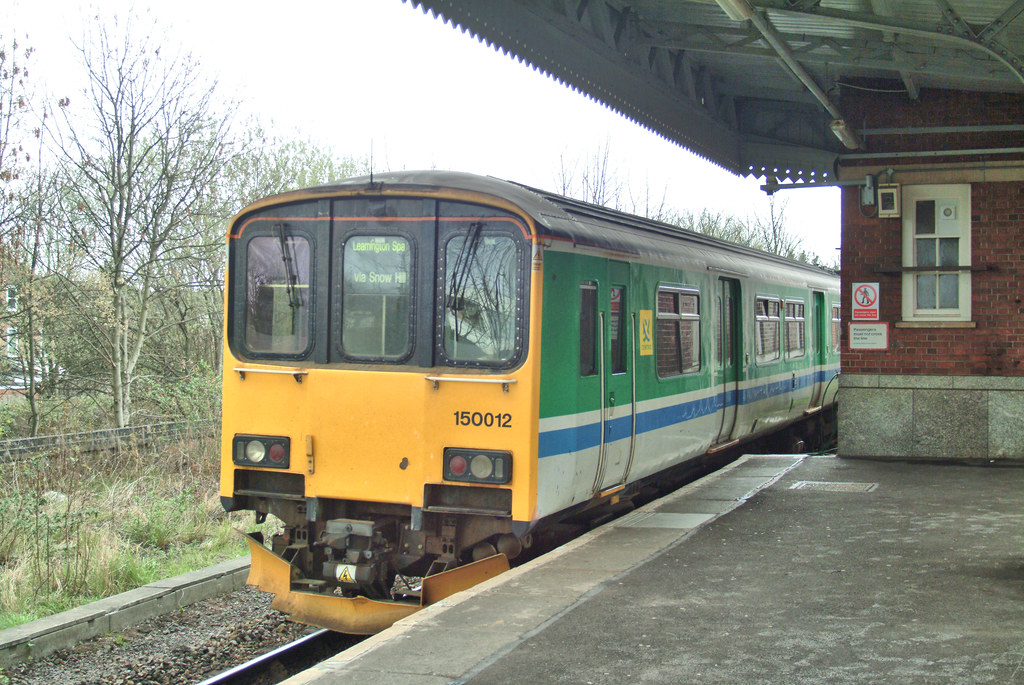

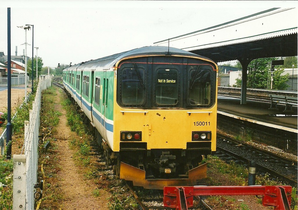

I found some photo evidence.
and
You'd get two in Platform 4, but I think you can only get one 3-car unit in Platform 1. So there must be two in the siding. Which is what the caption on this one sort of implies (but the siding is out of shot).
