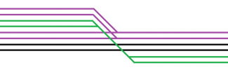

As for a flyover at Old Oak Common that's rather more fanciful that just speculative! It's quite a constrained site and you'd probably be knocking down North Pole Depot. The relief line connection via Greenford has more merit but again, there's unlikely to be an extensive service possible.
Doesn't this rather depend about where the current Crossrail lines into the depot split from the lines through the platforms at Old Oak?
There appears to be room for six running lines plus the pair of tracks into the depot.
So you might be able to rig something up using the existing flyover east of old oak that allows the two lines to still reach the depot but leapfrogs the Chiltern services over the two normal Crossrail lines.
EDIT:
I include a diagram of what I mean - this would be east of Old Oak.
Purple lines are Crossrail/Relief Lines, Black are the Regular Fast Lines to Reading, Green would be the Chiltern/Relief Lines
EDIT:
The HS2 station is between the Relief Lines and the CrossRail depot I don't see where your green Chiltern tracks would fit.
My understanding is that the classic station has eight platforms, and that the NNML diverges from the GW alignment west of the GWML station.
So the Chiltern trains would just occupy the two northernmost platforms at the Old Oak Common classic station.
The next two south of that would be Crossrail/Relief trains - then four platforms for fast services (possibly two shared with Crossrail for reserve purposes)
