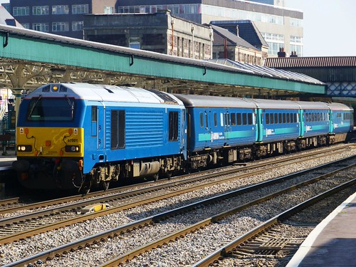

Oops :oops:. I haven't a clue really, but I was on a wonderful old-style train, it had a huge loco at the front end, then a big compartment that looked like it was for mail or something, then several rather plush coaches, all table seating, really comfortable seats, and there were even seascape murals painted on the end walls.
I wonder what it was then. Never seen it before or since.
That will have been ATWs' loco hauled rake, that is utilised during the week on the Holyhead - Cardiff Premier working. The mark 2 standard class carriages that are used on this service (There are two rakes) are often combined to provide additional capacity during major sporting events in Cardiff.
The WAG Express.

Great Pic but what is what looks like to be a Cricket Bat in the far front window?
when they were in use many years ago i saw them alot with what looks like a cricket bat in front window.
It's a wooden paddle normally used when paddling up 3rd rail units.
If you see one placed in the secondman's window as in the photo it indicates that the parking brake has been applied in that cab.
