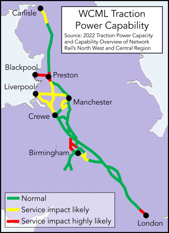

There's a 2022 map of the WCML that's coloured in terms of traction power capability - found in a Rail Engineer article.

Is the AT wire operational on Manchester-Liverpool and Manchester-Euxton?
I believe so, yes. I think Penwortham should relieve some of the yellow area south of Preston; once Crewe ATFS is commissioned, that should help a lot too.
Harker ATFS (north of Carlisle) should help south of there and across the border.
Interesting article but have to say was surprised to read this
For example, an overloaded feeder outside London required the closure of all four tracks for 10 minutes at a cost of circa £1 million. Frequent short outages also present a significant maintenance workload as switchgear oil must be filtered and refilled every 30 operations.
Surely they've eliminated all the 1960's oil filled switchgear by now? If not they should have recycled some of the redundant VCBs off the ECML this shouldn't be a restriction to operations.
