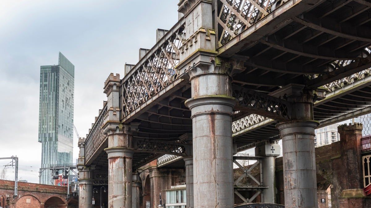

For example, Manchester Central, built between 1875 & 1880 - by which time the need for multiple track approaches would have been well understood. As well as the passenger terminus there were several big city-centre goods depots adjacent to Manchester Central, which probably needed separate parallel goods lines over the approach viaducts.
Looking at Google Maps, it certainly seems that Manchester Central had multiple track approaches on viaducts and bridges. These are separate to the earlier double-track MSJ&AR viaduct, still used by the Network Rail route to Warrington Central. Metrolink trams now use the southernmost viaducts which headed towards Manchester Central, the northern side trackbeds still look derelict.
