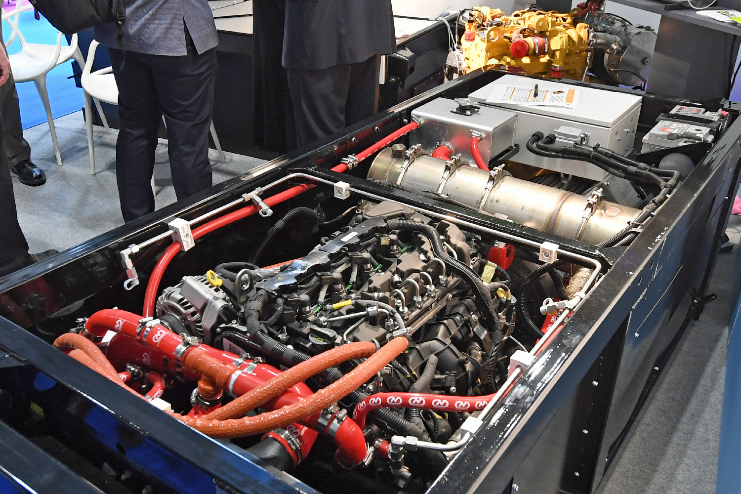

The Pollen clogging issue with the TfW 230s should have been a routine fix / improvement. Surely it affects all diesel trains ?. Although the engine raft is rather compact so airflow is a challenge.
Cars, vans and trucks don't suffer from their radiators being blocked with pollen either.
On all the DMUs I can think of, the radiator is a standalone unit mounted on one side of the underframe, with a belt-driven mechanical or electric fan behind it. There is a clear route for airflow through the radiator.. Cooling is also helped by the engine being mounted to the underframe and exposed to the airflow when the vehicle is moving (image of a Heljan O scale Class 153 model, but it shows the principle:
On the class 230 DEMUs, the engine and generator modules are mounted in steel box 'rafts' that are bolted transversely across the underframe. Motor cars have the batteries mounted in similar rafts., The trailer car has 4 genset rafts and a common fuel tank raft. Here is what a genset raft looks like (this is the updated design after the fire on 230001, as they originally had plastic oil and coolant tanks, and were using hydraulic hose for the fuel lines and plastic automotive fuel filters, all of which melted in the fire and added fuel to it):
The radiator is just out of shot in the bottom left corner.
The boost hoses being made up of off-the shelf silicone hose sections joined together with umpteen jubilee clips (each of which is an opportunity for a leak) rather than formed alloy pipes isn't a good look, in my opinion.
Looking at how that is laid out, the first question that comes to mind is 'How does the air thats drawn through the radiator into the box get out?' When the 3.2 Duratorq engine is used in Transits and Rangers, air comes into the grille through the radiator, past the engine and is sucked out under the vehicle due to the lower air pressure. As the radiator is front-mounted it is also exposed to increasing airflow as the vehicle speed increases, but they fitted with a belt-driven cooling fan which the ECU activates via a clutch if it feels the need.
Being side-mounted, the radiator on the raft is not directly exposed to the airflow and so a fan will be required to run constantly to draw air through it (this is the same as the 153, but that riadiator is open at the back and hasn't got an engine sitting right behind it either). The only place for the radiator exhaust air to exit is between the top of the raft and the firewall steel plate mounted under the floor of the car, and there is not much (if any) pressure differential there to help extract it either. The engine is also sitting enclosed in a box filled with the hot air that has been drawn through the radiator, not out in the airflow like on the 153.
I don't think pollen is really the issue, I think they just overheat in hot weather (just like the battery rafts do) due to poor airflow design through the cooling system, and then shut down. The same issue was seen with the Marston Vale units in warm weather. I think that the change to Caterpillar engines Vivarail were looking at for the Mk4 genset raft (you can see the yellow Cat engine in the background of the picture above) wouldn't have made much difference, though they may have been more suited to driving a generator at least - the 3.2 Duratorq is not used in any other genset application.
The design of the genset rafts was subcontracted to a third party (according to Vivarail in their report on the 230001 fire), and it was subsequently redesigned in house afterwards. From the image above, the redesign seems to have been mainly for fireproofing -swapping the plastic tanks for stainless steel and using proper fuel-rated hoses. I suspect the main driver in the design brief to that third party was that the genset had to fit into the raft system, as being able to reconfigure units to battery-only at a later date (once the fast charge system was working) by swapping genset rafts for battery rafts was one of the benefits they were proposing to customers. All other considerations (such as cooling) therefore had to be compromised.
A feature emphasised in early Vivarail marketing was the ability to swap out genset rafts in a siding using only a forklift, thereby reducing the frequency of depot visits for units based on a branch line.
I believe the original D-train concept was limited to diesel-electric units like the Marston Vale 230s. Vivarail only started developing battery and hybrid units later, after the success of the Class 379 IPEMU trial in 2015 (in which Vivarail was not involved).

From that picture it does look like airflow would be a challenge. I recall a selling point was that the engine rafts were supposed to be easy to swap out at a siding with a forklift so not needing full depot facilities. The idea of compatible fit rafts for batteries came later. Other changes for the unit to manage the hybrid mode would have been required.
The side facing the bottom right of the picture looks solid. I was wondering why it was not just a mesh BUT then I realised in some positions that raft would be right next to another raft !. I can guess the only exit route for the air drawn in through the radiator is downwards ?. Possibly out the other end - so opposite side of the undercarriage. But then it could be drawn in by an adjacent raft as I would assume an adjacent engine raft would be arranged with its engine on the other side of the undercarriage to balance the weight out.
The report on the Mk1 genset raft fire on 230001 suggests that the genset raft walls and floors are all solid apart from some drain holes in the floor plate (the only place they could fire the handheld extinguisher through was the radiator) There is a picture of the damaged genset being removed with a forklift which shows it also has a lid as well, which is also mentioned in the text and that the aluminium intercooler melted onto the top of the engine Added together, it looks like the exhaust air from the radiator exits the raft through an aperture in the lid, passing through the intercooler as it does so. This is why all the other sides of the raft apart from the radiator end have to be solid, otherwise there would be insufficient airflow to cool the inlet charge air for the engine (later on in the report, it states that the gas from the raft's fire suppession system failed to put out the fire because it was mostly blown straight out through the lid by the radiator fans).
The presumed source of fuel for the fire in the report was a fuel leak on the union connecting a high pressure fuel pipe to one of the injectors. When the other gensets were examined, similar leaks were found on almost all of them. after having had engine work or fuel system work done. Vivarail had been told by the genset supplier that the high pressure pipes could be reused if they were not damaged, but they had since checked the Ford workshop manual while doing in-house routine maintenance which had said any pipes had to be replaced if they were disturbed during work on the engine;
Anybody who has worked on modern diesel engines (and even petrol engines with high pressure direct injection) would know that the manufacturer's instructions always state that fuel injector hard lines are single use only items, as they seal by being deformed when they are tightened (the fact that they had to keep tightening the injector unions as they kept coming loose and leaking is evidence of this). Vivarail taking the genset supplier's (who were presumably trying to save a few quid by reusing them) word on this issue and then having to look it up is another thing, like the silicone boost pipe arrangement in my previous post, which should not have inspired confidence in their engineering expertise.
