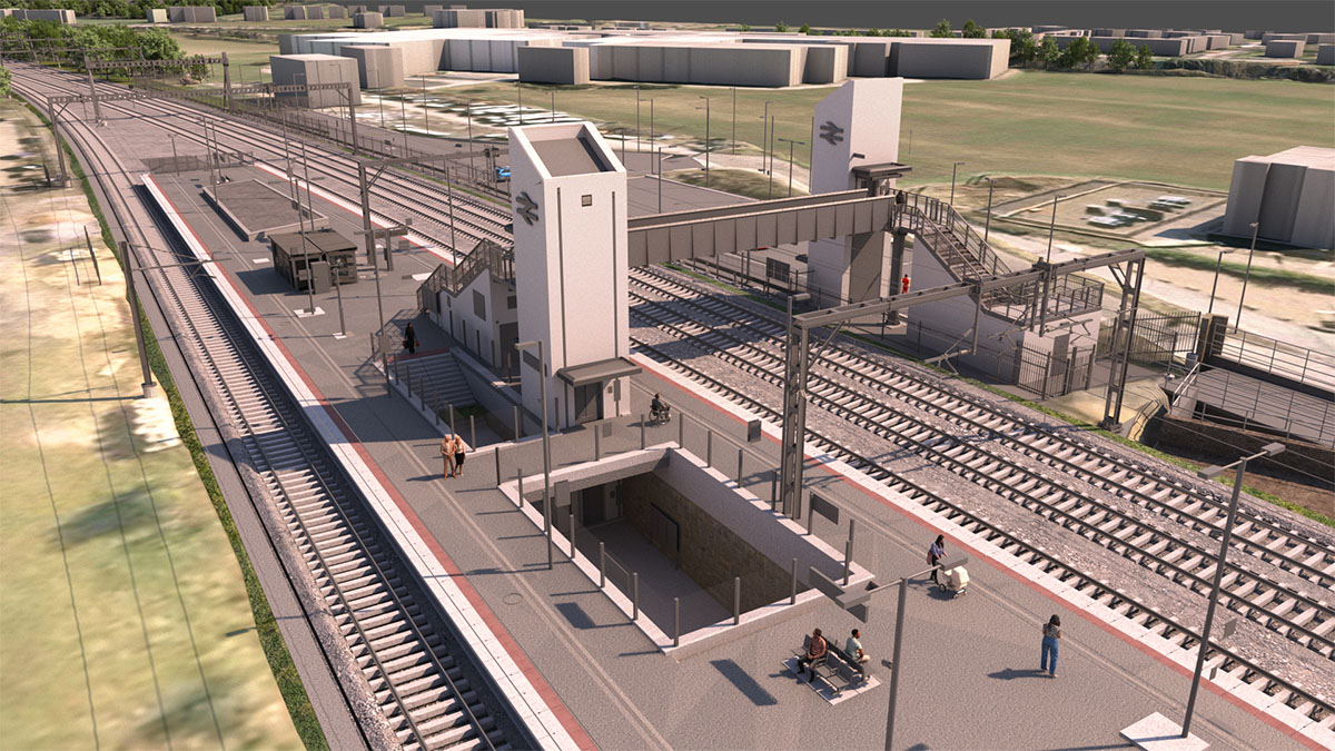

That was my thinking too- though the current car park and platform 3 is on the wrong side of station road from the island, so any new access will require a pedestrian walkway to the new bridge. This disused bridge under discussion would provide that. The drawings suggest as much.
Must say I'm not in favour of infilling the current stairwell, although there have been problems with subsidence on the island platform over the years particularly near the top of those stairs. One advantage of the stairs is the convenient access they provide to Mirfield village, the Lidl, and the Navigation Inn. Having to go "round the houses" to enter or exit the station will be a bit of a pain in the proverbial.
I found this image online for Mirfield. It looks like there will be a staircase and lift from station road to platform level, albeit from the other side of the road.
Maybe they will they gate off the current access at road level to platforms 1/2 and just make a feature of the station's former entrance/exit at platform level...
I would hope that the island platform will be completely ripped up and started again. Over the years there have been multiple cases of subsidence due to corners being cut when the station was downgraded in the post-WW2 period. I wouldn't be averse to the current stairwell becoming a flowerbed, as long as it's built to last and won't start sinking within ten years.
Indeed it's in the press release linked in #7315.

Works have advanced - Piling for electrification between Church Fenton and Micklefield, the replacement of the footbridge at Garforth and clearing taking place around Neville Hill to realign the running lines.
Subsidence tends to settle down over time so maybe its a historic issue....Regarding the platforms, one hopes they would completely renew everything rather than skimp now and then have some issues in 5/10 years time....!!
Apologies for the pedantry but the Garforth work isn't TRU, it's a long funded Access for All scheme :)
