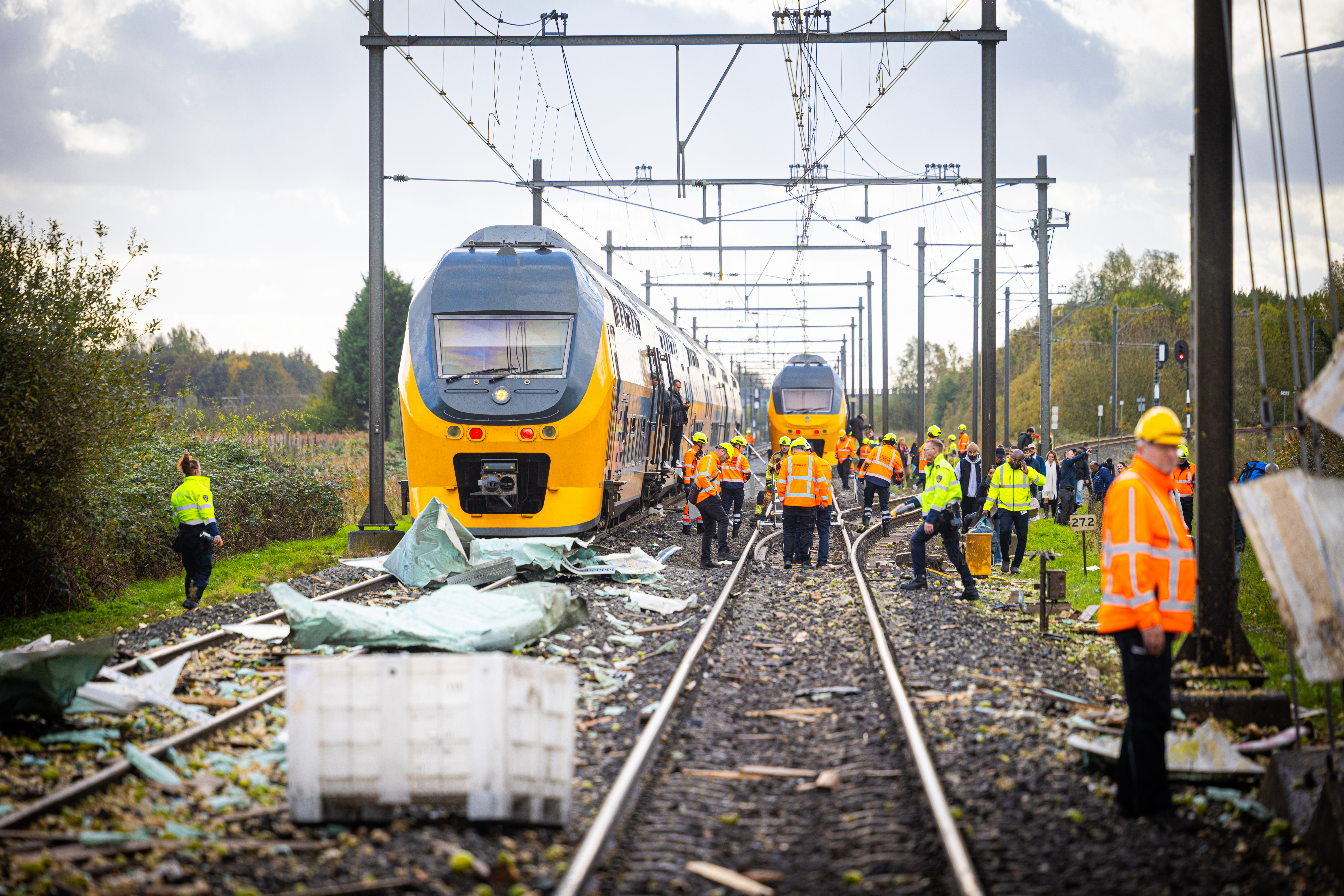

Yesterday there was a big crash in the Netherlands at a level crossing in Meteren, between Utrecht and 's-Hertogenbosch. ProRail has released a video from a crash showing the truck doing a bizar manoeuvre on the level crossing:
The first car of the train derailed and detached itself from the rest of the train but stayed nearly straight so there were only a few minor injuries. A second train coming from the other direction was grazed by the derailed car but stayed on the track and was able to stop before the level crossing. The track was damaged severely and they expect it takes until next Friday to repair it.

Holy crap, that's serious. It's remarkable there weren't more injuries.
I can't work out what the hell the truck driver was doing ......was his trailer grounding on the crossing, causing him to try to reverse and take another line over the crossing? Bizarre manoeuvre indeed!

Maybe the truck is trying to reverse into the turning on the left, just before the tracks?
Baxenden Bank
23 Oct 2013
4,750
Replies to the video clip on twitter suggest that may be the case. The road left before the crossing being a cul-de-sac with no turning place.

Later media reports, including the video posted by @Beebman, state a slightly different cause: the truck was supposed to drive to a weighing bridge after loading. That weighing bridge was located at a different company's site directly next to the railway.
For some reason, I've seen the explanation differ between media, the truck driver drove past the weighing bridge and ended up on the level crossing a few meters further. So that would explain why he was trying to reverse into the road on the left, enabling him to drive back to the weighing bridge.
