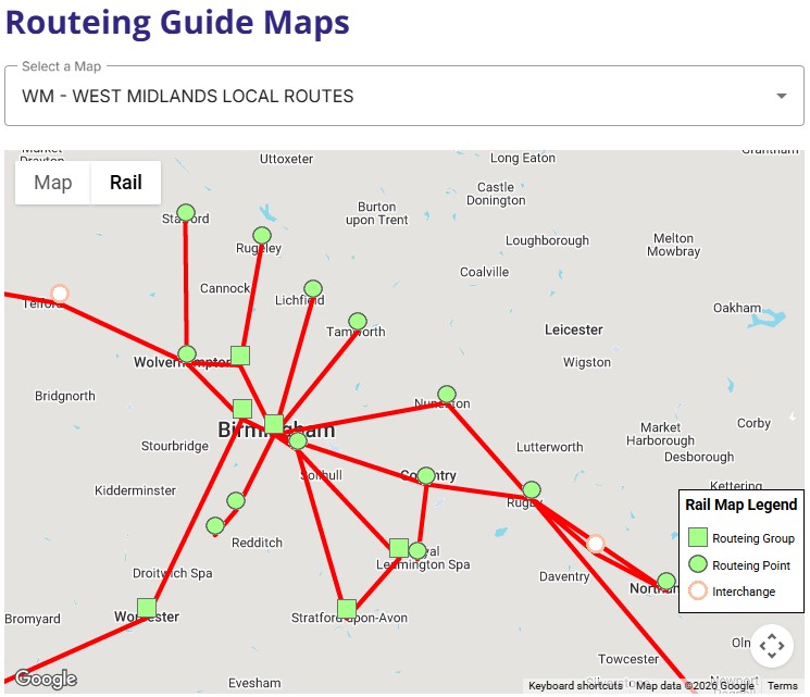

Coventry to Tamworth is interesting though, the forum site will offer me an itinerary:
Outbound: COV-BHI-BHM-NUN-TAM (Mapped via TL https://vaildata.uk/routeing?orp=COV&drp=TAM&map=TL)
Return: TAM-BHM-NUN-RUG-COV (Mapped via WM https://vaildata.uk/routeing?orp=TAM&drp=COV&map=WM) (to be clear that's RUGby not RuGeLey)
Interesting that a valid route from Tamworth to Coventry could include going into Birmingham, back out to Nuneaton, down to Rugby, and back up to Coventry. It's a bit circuitous, but mapped. If I wanted to switch a Rugeley dwell for a Rugby dwell it could be fun. It's practically a mini ranger. Link to Forum ticket site:
https://tickets.railforums.co.uk/re...0C0&adv:ib:Via=7010770C60,7011270P,7010870C30
I could then add the same £3.50 COV-BHM single, staying on the same train from Rugby to Coventry back to Birmingham, total £17.80! Thanks for the inspiration!

Wait COV-TAM is valid to go into BHM and back out to Nuneaton?! Last time I had that ticket I got a "via Nuneaton" routed fare (I think) and tried to route excess one direction via Birmingham but maybe that wasn't necessary?
Royston Vasey
14 May 2008
3,001
Cambridge
I can certainly get an itinerary and it doesn't seem to violate the routeing guide... from my non expert reading of the routeing points... perhaps the Trainsplit/Forum staff could comment? @Mike395
MrJeeves
28 Aug 2015
4,724
Burgess Hill
I certainly don't think it's intended to be used in this way, but yes it's valid.
You can use the split routeing rule to take any permitted route from Coventry to Nuneaton, which could be Coventry - Birmingham - Nuneaton, and then you can take any permitted route from Nuneaton to Tamworth which would only the direct route.
This makes the journey permitted, compared to the mapped routes for Coventry to Tamworth which wouldn't allow the portion of the journey from Nuneaton to Tamworth in the screenshot from @Royston Vasey above.
The same rule can be (ab)used for a lot of geographically routed tickets with very interesting results. In this case, the Via Nuneaton fare lets you do everything the Any Permitted does, and more.
