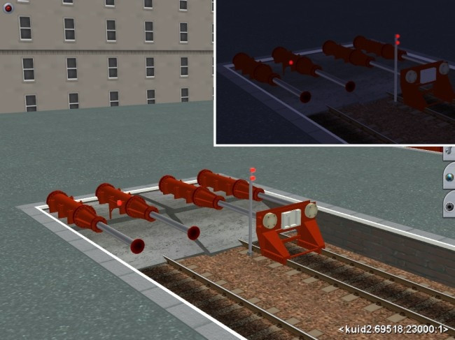

I made a couple of models of these buffers for Trainz. Were quite popular.
Hydraulic Buffers - Modified
Hydraulic Buffers - Original
