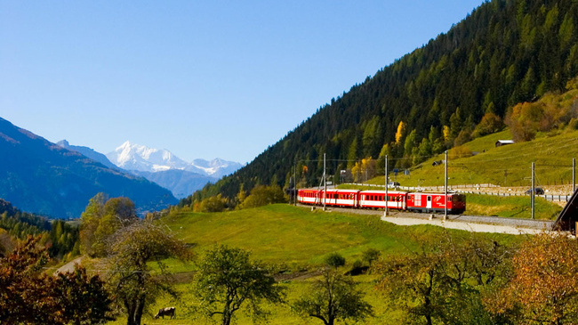

Switzerland is a country of great scenic beauty and all lines are electrified. Only the Martigny to Chamonix line uses third rail and even that uses OHLE on the final run into Martigny.
Also bear in mind that most railways originally had a line of telegraph poles along their length. Modern practice has taken away that visual intrusion.
