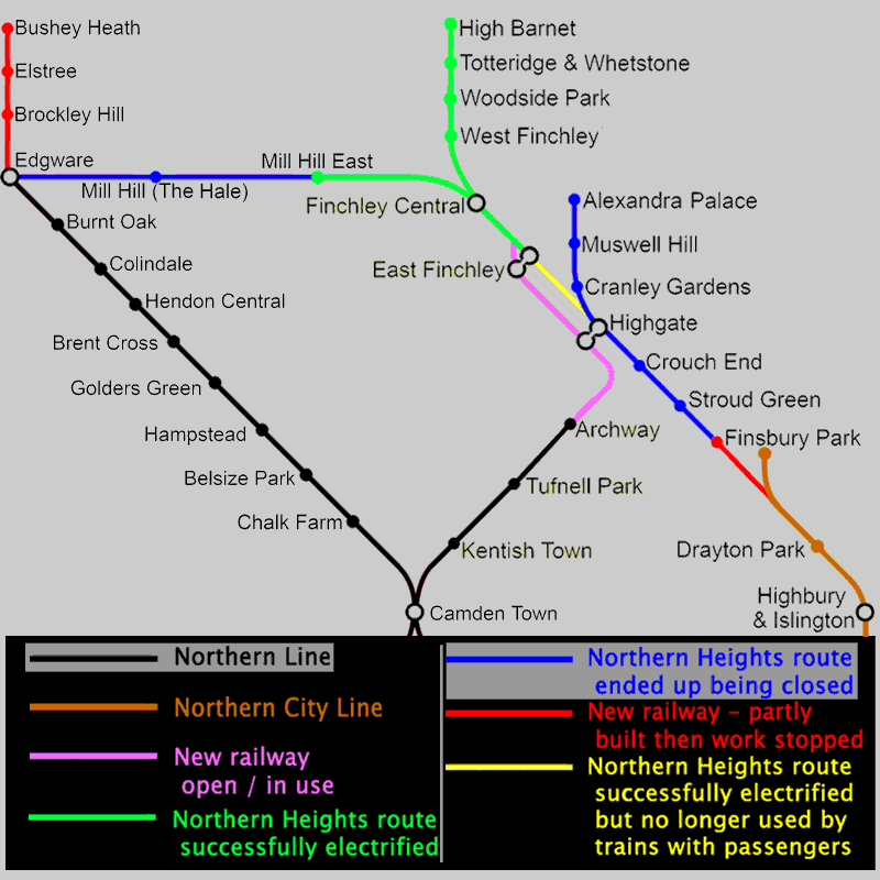

Here is a diagrammatic plan...
Its something I drew a few years ago, for use on my website. The unusual background colour matches the background image on the web page (white would have stood out like the proverbial sore thumb)
