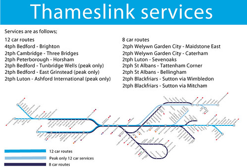

This was one version of the expected routes given;
Thameslink 2018 services by Sparkyscrum, on Flickr
But the recent consultation has changed this with news that Kent mainline services will need to be via Herne Hill rather than London Bridge as shown.

Nothing I've ever seen supports 4 tph 'Thameslink' to both of Cat AND Tat.
The London and SE RUS had 2 tph to each, then that route diagram posted here a few months back had 4 tph to Cat and none to Tat.
Given there are only up to 14 tph proposed for the total service through East Croydon, it is highly unlikely that you are looking at more than 4 tph for those routes combined, as Brighton has always had 4 tph, and they want another 4 tph through Three Bridges to allow semi fasts via Redhill. There are also likely to be 2 tph from East Grinstead peak only. Eventually you run out of slots given that 14 tph total...
But as Class377/5 has said, the current Thameslink/Southern consultation will result in even more proposals towards the final decision, so it's really a question of waiting.
