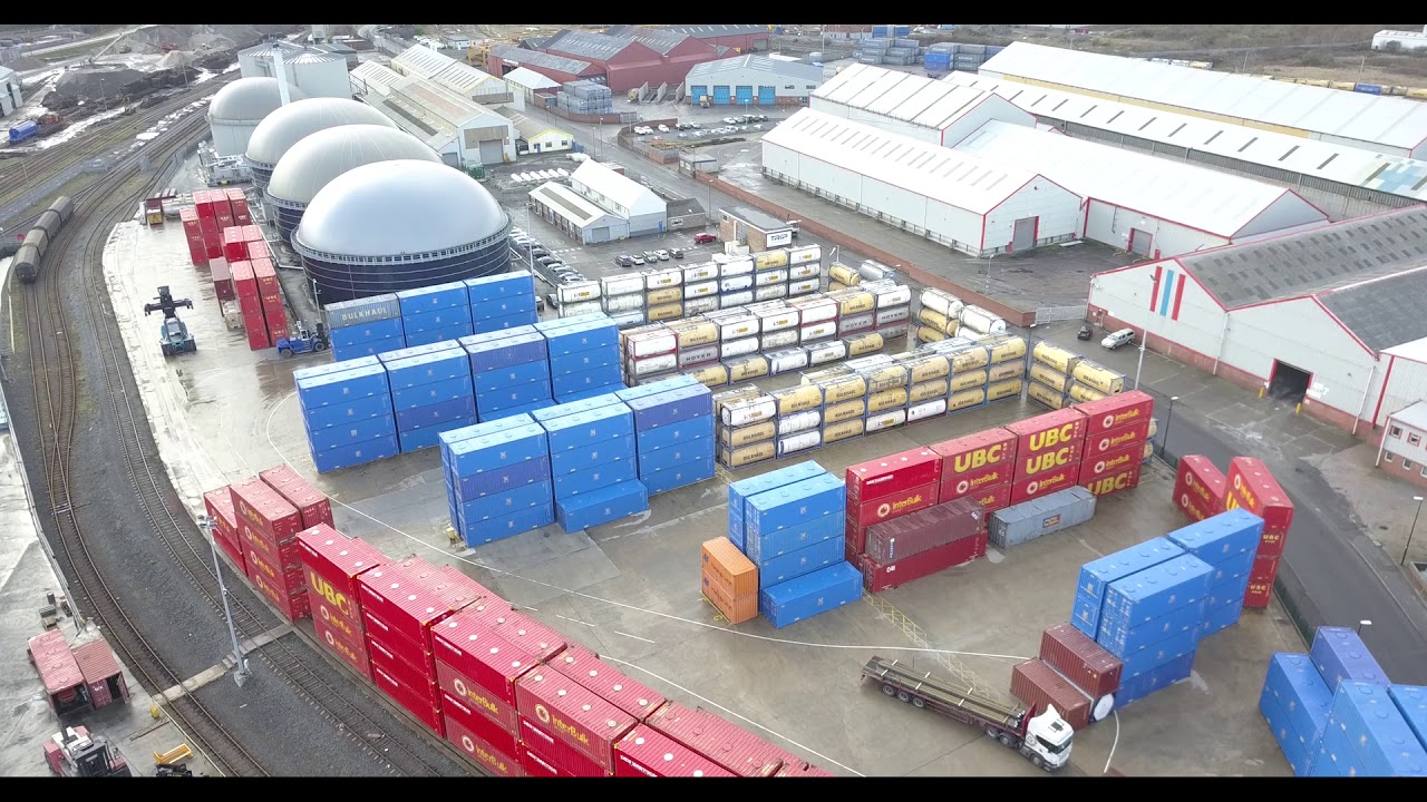

A.V. Dawson videos:
There are some good blink-and-you'll-miss-it views of Middlesbrough Goods / TRIP (Tees Riverside Intermodal Park) e.t.c on A.V. Dawson's own Youtube channel- worth watching at 1/4 speed and pausing...

0:14 View of the two sidings beneath the covered loading area "rail canopy" where a train of gypsum containers is stabled. Next to that the inlet & outlet lines join to go around to Ayrton terminal, and there are potash/rock salt hopper wagons stabled in the yard over to the left.

1:29 Sidings at TRIP
2:52 Containers in TRIP

5:12 Drone View of site. Back of steel warehouse, unused line from quayside nearest. Line curves round into Ayrton terminal past the blue containers in TRIP and over Forty Foot road crossing.
Potash/rock salt wagons in the yard with Cobra warehouse, piles of rock salt and exit to main line beyond.

Video: AV Dawson - TRIP
Notes: Drone view of TRIP. The rail canopy (covered bulk loading facility) has since been built next to the domes.
