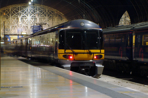

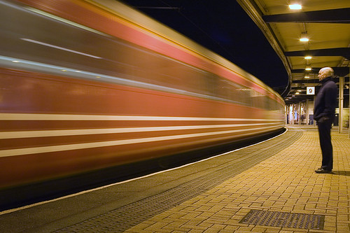

If you're using a tripod turn on mirror lockup in custom functions and use the timer. This will move the mirror up a few seconds before actually taking the photo to reduce any vibrations from the mirror moving.
ISO100, 20 seconds, F11
ISO100, 2.5 seconds, F8
ISO160, 5 seconds, F11

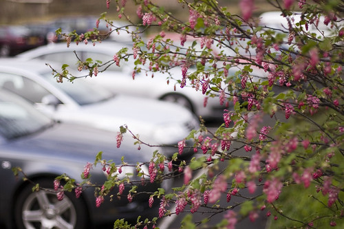

The F number is the aperture (how much light is allowed through the lens). A low aperture allows lots of light through allowing a slower shutter speed. But the downside is it reduces the depth of field of the photo (how much is in focus). Somewhere around F8-F11 allows a decent depth of field. Something lower is good if you want to blur the background to make something stand out.
These two photos were taken at F1.8, you can see the effect that focusing at different distances has.
