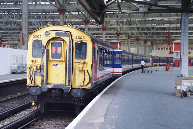

What were those slammers which had buffets and modern seating ie not bench style. Were these classed as long distance stock? Any pics? They used to run between havant and guildford and were Orange painted inside

These?When I first signed these units I didn't get on them much as I didn't sign Pompey.
Used to do empties to Clapham Yard on them though.Happy days.

Thats them! They must have been refurbished by nse. Love the look of them

4BEP's, a CEP with a buffet wagon inserted. Never been on one, I only had the bog standard CEP's down on the South Eastern. There was a CIG equivalent on the Brighton lines called a BIG.

Great units,loved them,they were like a tank on rails.
There were 7 of them originally,well when I joined the South Western Division in 1989...There were others.I found a pic of 2317...There were others converted from the CEPs but I dont think they had buffets on board.I do remember them also.
Also on a side note the newly converted batch were "greyhound" like the original 7...Faster acceleration as far as I remember.

A Greyhound was a CIG with (I think, not too hot on EMU technicalities) an extra weak field position on the power controller, essentially allowing 100mph running and very rapid acceleration.
Almost :D A greyhound had an extra set of weak field resistances which were brought into use by an extra step on the camshaft/current limit relay after normal weak field. I can't remember the speed this came in at though but I think it was around 50mph(?). Greyhounds had stickers on the drivers desks to remind drivers that the unit was a greyhound as it was quite easy to end up going quite a bit quicker than a normal unit without realising it and, of course, the brakes weren't modified in any way to suit the extra speed. Official top speed was still 90mph though.
No the power controller still had the original four notches.Faster acceleration though.:p
I think 2317 was a renumbering from 2307 when the buffet cars were switched around near the end of their days?
Now you have jogged my memory I think the reason was that the buffet car was taken out and replaced with a "normal" coach from a CEP but these units still retained "greyhound" capability.As we also had the kent coasters (CEPS) it could get a bit confusing as they looked the same as these units but didn't have the "greyhound" capability.
