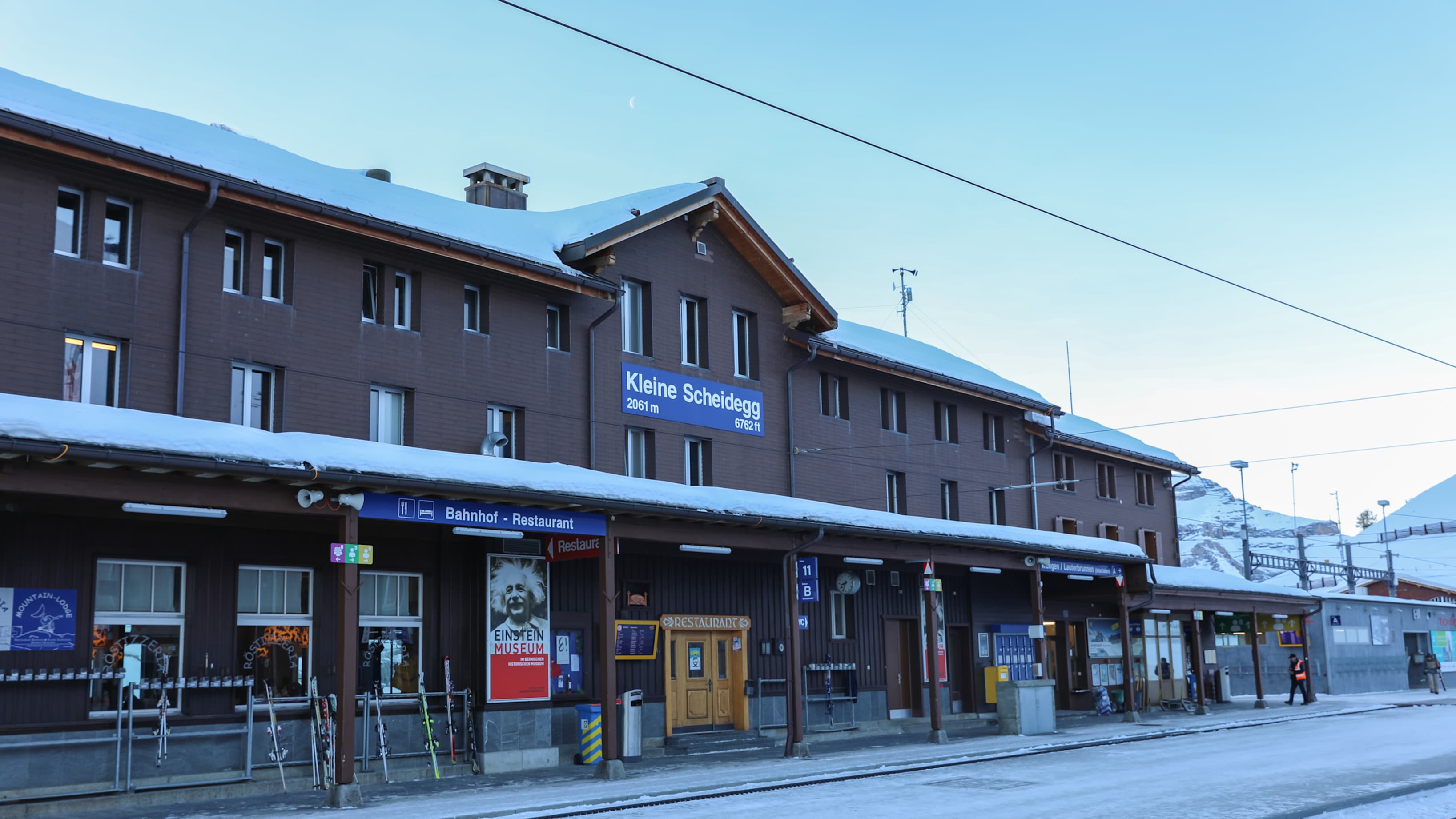

I also half recall the Grindelwald-Kleine Scheidegg railway has a few similar units but I couldn't find photos of them.
Those are quite interesting units - they're basically a narrow gauge GTW, but instead of the short power pack they have the panoramic coach with a high floor and the gubbins underneath (I think). They remind me a bit of a Sheffield tram in concept.
Edit: I've now found a picture of the Grindelwald ones:
Not sure if they're Stadler though, but they're the same idea.
They look very similar to the SPATZ apart from the narrower gauge.
