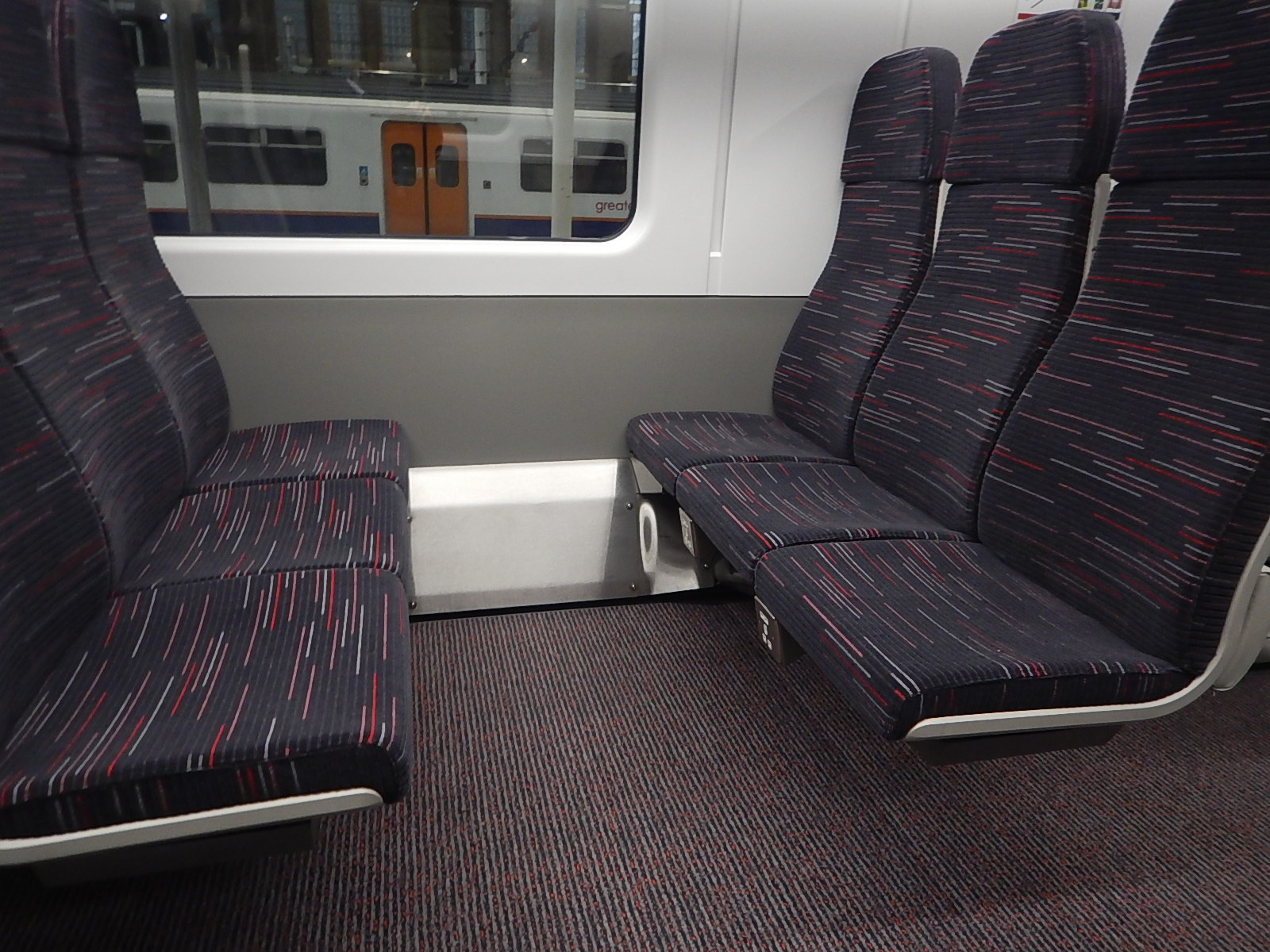

This image suggests that the third seat is indeed floating. Seems drastic cutting them out, but then it would produce an ideal airport train as you say.
There does seem to be a panel near the door that would need cutting as well, but again it should be doable.
The seats nearest to the gangway show what a 2+2 would be like
(Got the image from Google search, so do not know the origin.)
113,091
Thanks. From that pic it looks like the second option (take the seat off and lop the end of the frame off) but still fairly trivial and would be a serious improvement for these units.

IIRC when I had a look underneath it was not possible to remove the third seat without significant modification or replacement of the the cantilever arm. Addition of tables would also be very nice. Armrests may be quite difficult to add to the current seats , as well as narrowing the aisle. Anyways, I find armrests a bit redundant if I am actually using the tables.
I think the entire fleet needs these modifications, and then ~8 should have a row of seats on one side at each door removed for a luggage rack for the Stansted route.
Assuming the aim is a lot of standing space (e.g. 357 metro) and to only seat 3 UK (fewer US) standard bum cheeks per side rather than full normal sized 2+2 seats.

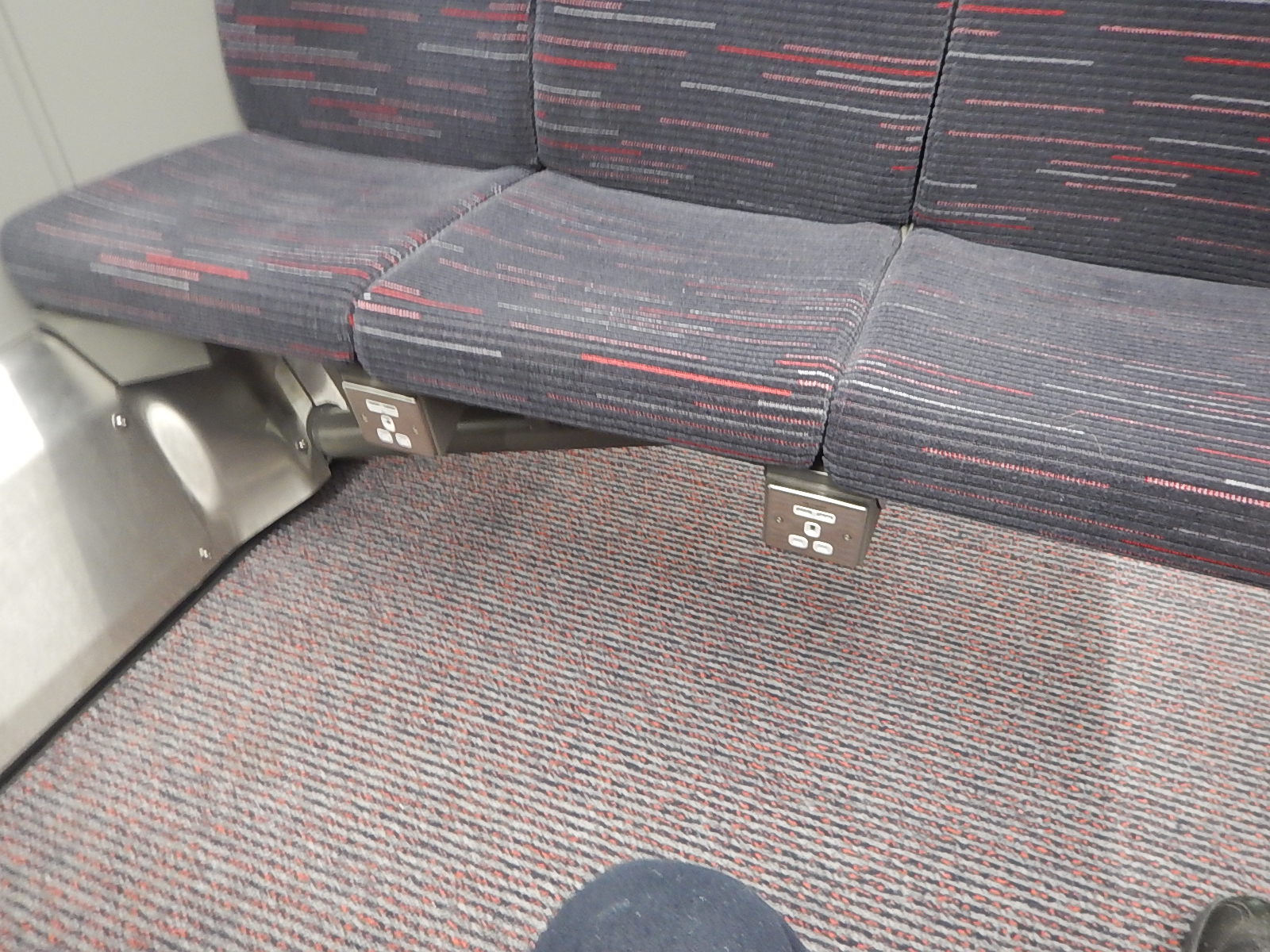

I've taken a photo of the seat underside showing that a new cantilever beam would be required to remove the third seat. There are structural parts that would need to be cut off.
