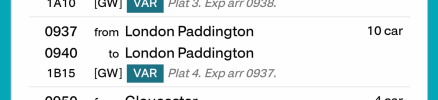

I don't know if it's RTT's side, or the data it receives, but some London Paddington to Swansea trains show as "London Paddington to London Paddington", as seen here:
What it looks like is if part of that train splits at Swansea, and stays on the platform to attach to a London bound service, it shows as one through service.
I think that's a consequence of the data, since RTT connects trains that join into single lists (on simple mode)
This is dodgy portion working data - the join at Swansea on that service is marked as public incorrectly. RTT has some level of protection against it but it can’t fix everything.
