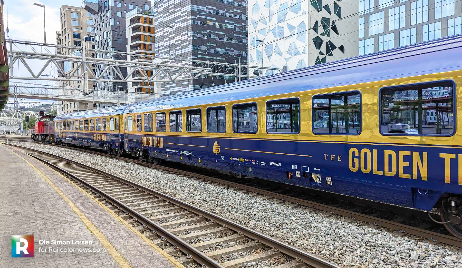

Picture from @Lxd2 is interesting to see - thanks very much. In itself an interesting unit to ride in as I've never experienced one. Thanks @Gloster for the identification. But very much not what the current Golden Train website is suggesting you might travel in. I wonder if those are used on non cruise ship docking days (when lighter loads are expected) or simply how the service was run before now. See below link which implies the current rolling stock was perhaps outshopped in summer 2024
I only suggest that because I located this link - and although the article is only available to subscribers, the picture of branded loco hauled stock - seemingly coming out after refurb or at least re-livery is viewable and dated July 2024. Suggesting a new rake was being assembled for the service perhaps.
See link:
The Golden Train of Norway – first coaches released - 24-7-2024
which match pics on The Golden Train website of their vehicles.
Or maybe the service has been cranked up to carry far more people than it historically did.

Interesting. Those refurbished coaches look very smart. I see that the Golden Train (in its current incarnation) only started in April 2024, so the Y1 railcar was probably a stopgap solution that was available quickly, though they may well keep it for use on quieter days.
This article explains the origin of the loco (former Danish ME) and coaches (former DB IC coaches), and also the improvised generator van to provide train power:
Further south, on the Raumabanen in the Norwegian Fjordland, this exact solution exists. There, the tourist train "The Golden Train" runs between Åndalsnes and Bjorli, now with five former Deutsche Bahn Intercity carriages instead of the previous three. It is pulled by a former Danish ME diesel locomotive without a power supply for passenger cars. Therefore, the company responsible, Taralksvik, uses an improvised solution to power the train, with two mobile diesel generators mounted on a flat car.
The loco seems to be one of former Danish State Railways Class ME owned by Swedish Nordic Re-Finance. The Fde train heating vehicles are three former Rps wagons from the early 1970s that were rebuilt in 1990 and 1991 for the Nordlandsbanan to Bodø by fitting container like structures on them. Whether these can be spared from the Nordlandsbanan in the long term is a question, but I (personally) feel that getting the night train to Bodø back is a better use than a tourist train. N.b. I think that the company involved is Taraldsvik, a Narvik based company that has had its fingers in various railway pies in recent years.
Many thanks for this link - informative indeed! I've just read the translated page in full. Given the aesthetic qualities of the loco and especially flat bed generator vehicles I can see why they don't feature on the official Golden Trian website imagery:lol:
I guess we might yet get a report from a forum member who has used the service recently, and the train in this current guise with the ex DB carriages - otherwise it will fall to me to provide a decent trip report for future travellers for the forum later in the summer!
Thanks for this added info which is all of interest. I'm going to read up about that class of loco.
