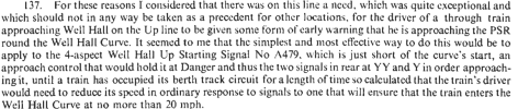

This is an excerpt from the report into the 1972 accident at Eltham Well Hall, when a train derailed on a 20mph curve after a long unrestricted section: https://www.railwaysarchive.co.uk/documents/DoE_Eltham1972.pdf
This would have been around the time the Preston signalling was being designed, although the report wasn't published until 1973. I wonder if the designers had in mind the risk that something similar could happen there, a less severe speed restriction but also a risk of head-on collision at the junction.
That's a plausible explanation given the circumstances & timing. The Eltham accident occurred on 11 June 1972, while the Preston PSB Signalling Notice diagram was issued in October 1972 for new arrangements commissioned on 22/23 October 1972.
Possibly the original design and installation of PN14 had been for a conventional 4-aspect signal, which was modified at a late stage, post Eltham.
