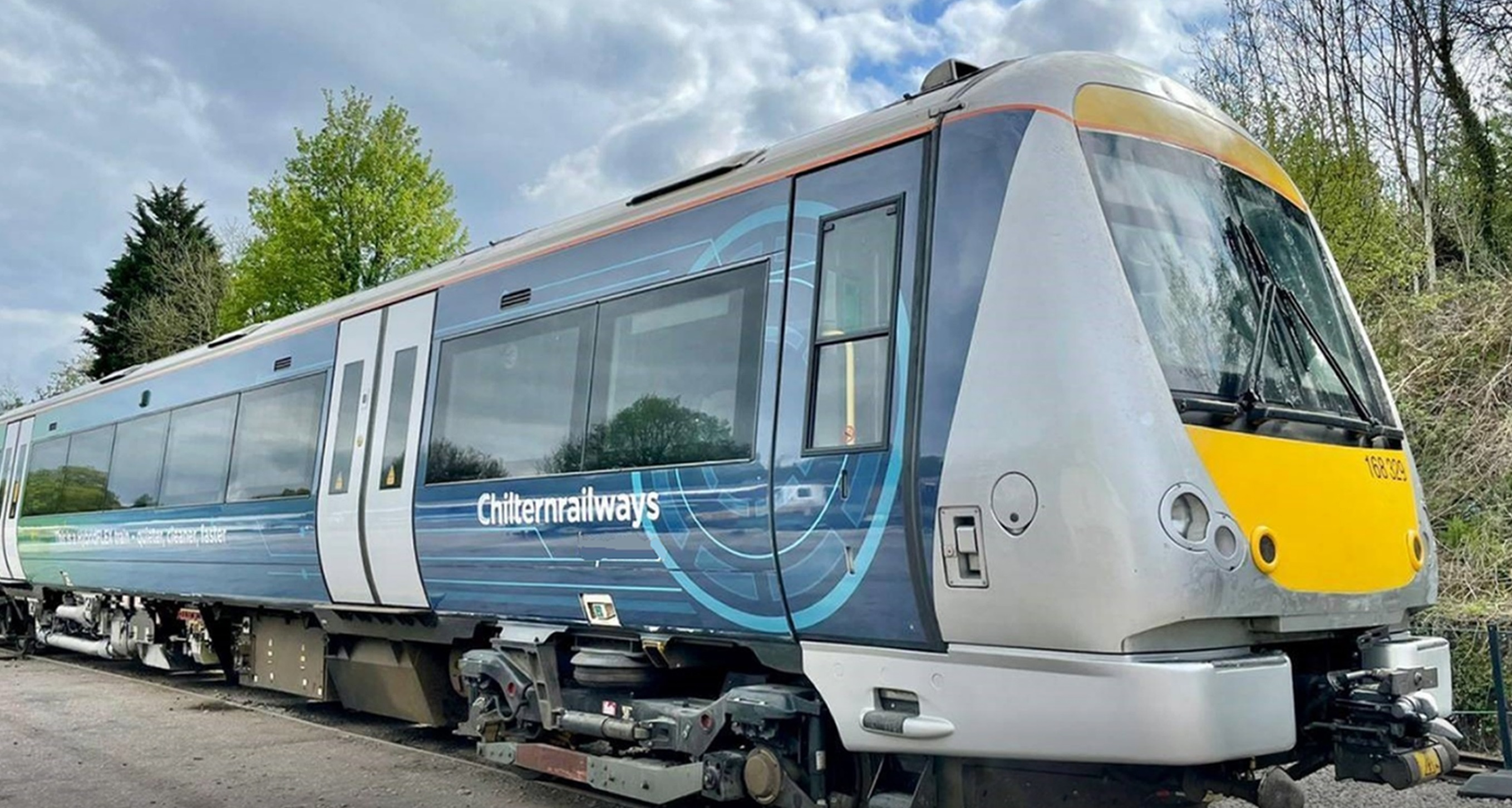

Britain’s very first 100mph battery-diesel hybrid train is entering passenger service to cut carbon emissions and boost air quality.
Chiltern Railways will introduce the train on its 40-mile route between London Marylebone and Aylesbury, Buckinghamshire, today.
There are plans to use it between the capital and Oxford in the coming months.
Their twitter says it's not in passenger service yet.
Railwaysceptic
6 Nov 2017
1,738
Interesting but with little detail. Will the batteries be re-charged when running over the third rail sections or will the diesel engine do it?
As overhead electrification in St. Johns Wood and Hampstead tunnels would be challenging, this hybrid holds great promise.
Mikey C
11 Feb 2013
8,285
I assume this is like a self charging hybrid car or bus, where the engines and braking power the battery. I imagine the main benefit will be for air quality at stations, where the train can arrive and depart using battery power
