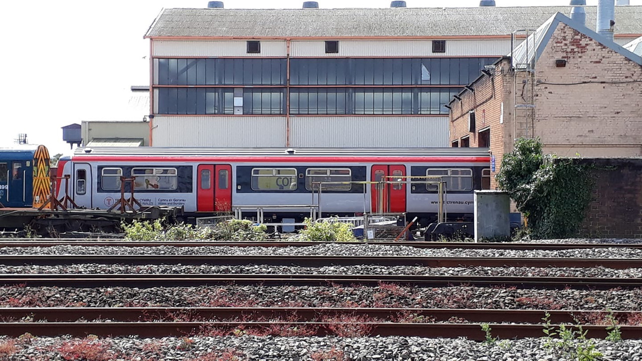

Apparently one of the 769s is outside the Pullman rail yard at Canton in tfw livery
which one is it though...? is it 008...?
