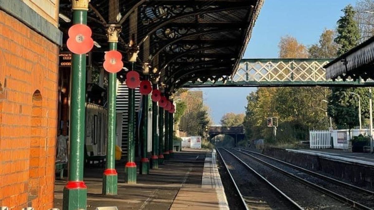

A number of commemorative poppies have been removed from Hale Station - as they were deemed to potentially confuse train drivers.
Large poppies have in recent years been mounted on pillars at Hale Station as part of the village's Hale Remembers period of commemoration in the lead-up to Remembrance Sunday.
But Denise Laver, from Hale Civic Society, said the poppies were removed yesterday by ISS cleaning services, a contractor working for Northern Rail.
A spokesperson for Northern Rail has now told Altrincham Today that the poppies were removed because they could be "confused for a signal".
They said: "We welcome the display of poppies at our stations but these should not be in the driver’s line of sight where they may be confused for a signal and compromise both customer and railway staff safety.
"In October, we wrote to station adoption groups and other volunteer organisations connected to our estate about this issue.
"Poppies displayed in unsafe locations are therefore removed for safe keeping and returned to the appropriate adoption or volunteer group on the condition that they are displayed in a more suitable location at the station."

Maybe just don’t put big red circular objects on the platform without consulting the operational side of the railway?

Sounds like usual (present day) H&S BS. If a driver confused those with a signal, then I would call in to question the TOC's driver selection and training processes. Is it not time we (as a country) took back control of what is a genuine risk, and what is not....sorry, a tad grumpy today, but my point stands.

And in the extremely unlikely circumstance a driver did mistake it for red, that's the safest aspect you can assume and won't cause any danger. I can literally not think of any time that thinking that is a red signal would compromise safety.

I assume one danger is a driver thinking 'oh it's just the poppys I can see' and then have a SPAR at the signal just ahead (showing YY in the photo)
Complacency is dangerous. Confusion is dangerous.

Might well obscure stop car marks/turn back marks etc., plus a general distraction risk. Whoever put them up should have checked first (and had more sense).

Perhaps had the poppies been bolted to the pillars at 90 degrees to the line of route, then maybe the drivers would not have seen them ?

Wasn’t Eccles (1984) felt to have been contributed to by the colour of buildings behind signals.

Doesn’t necessary have to be a signal though. Could be mistaken for a red hand lamp or red flag. Then in turn if someone is displaying a red flag or lamp a driver may think “oh it’s just the poppies” and ignore it. The likelihood of it happening is slim but it’s always a chance.
I’ve come around a corner before and at first glance thought a red poppy is a signal, despite a signal not being there and it being on the opposite side of the track before realising what it is.
There’s plenty more places a poppy can be displayed, there’s no need to display them where they may interfere with the running of trains.
Clearly my Tocs selection process and training needs to be questioned

Northern's guidance to station adoption groups includes not erecting anything that could potentially obstruct or confuse sight lines to signalling. That includes Christmas lights and reminders about that are usually sent round about this time of year. Ornamental shrubs can grow happily for years but are subject to the same rules. if a SPAD occurs, or is reported as possible, and the shrubs are cited as a contributory factor they too will very quickly be removed. Vegetation all around the railway is rampant and small ornamental plants on platforms can also get out of hand.
The ready availability of these big poppies and cheap Christmas lights encourage volunteers to splash out. However the case highlighted here was probably compounded by orientating them all to face towards oncoming trains rather than being parallel with the tracks and possibly facing inwards.
No offence intended my friend. As someone eluded to up thread, a better position would be to have those poppies (in the pic) bolted on so that they are edge-on to approaching trains, which makes better sense all round - intending passengers, and those sitting on a train stopped at the platform, will then have a better view of them, and drivers wouldn't see 'red'.

For the station illustrated here they could have been turned 90 degrees to face the opposite platform. But no, they had to be ripped down and a huge "Nanny Knows Best" press release written and sent out to all who might print it.
