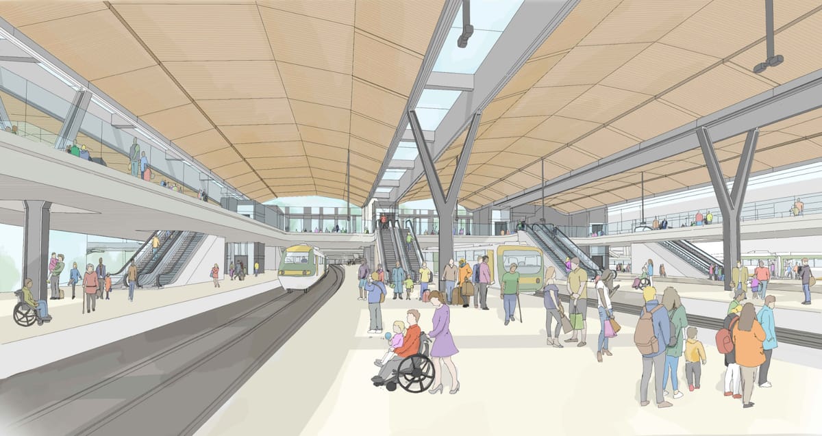

London Reconnections have done an updated article about what is now the “East Croydon To Selhurst Junction Capacity Enhancement scheme”. Not new information as such, but it’s basically a good summary of what we were discussing earlier this month, with updates to their track diagram:
“As far as we can tell, there are three changes of significance. They are:
An eighth track under Windmill Bridge (up from seven).
A conflict free route from the Victoria Down Fast to the Down Slow at East Croydon has been added (in fact there was always passive provision for this, although this fact was not generally made public).
East Croydon station appears to have moved 100 metres to the north compared to previous plans. More accurately, the platforms now have a common alignment and existing main station entrance has been replaced by an upgraded entrance around 100 metres to the north of it.”
