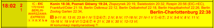

EC40 is fully sold out in 2nd class today. Reservations are not mandatory up to Rzepin - see "W komunikacji międzynarodowej [R]" below, which translates to "Reservations compulsory for international passengers" - which is why PKP is happy to let you book as far as Rzepin.

Reports seem to agree that they're not enforced in practice. The train is not fully booked, but there is not one seat available for the whole length of the journey. You could e.g. split in Rzepin.
I see. That's a pain (I should have sorted it out last night). I've booked on an earlier train to Poznan to get as far as I can with a guaranteed seat. As I need to make the sleeper in Berlin so transferring to slower trains isn’t really an option, I may try my luck nursing food and drink in the restaurant car.
As I wrote: you can use EC40 and split the reservation in Rzepin. No need to leave earlier.
