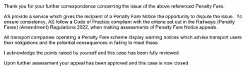

bdt2712
22 Dec 2024
12
Hinckley
2nd appeal successful! Honestly really appreciate everyone’s help with this, you guys have been great and are the reason I’ve been successful with this. So big thank you
