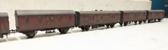

I finally got round to doing some weathering and trying to finish some bits. This ex-GWR P19 CCT is done, bar the couplings... (Which will be interesting as there is a cross handbrake rod exactly where the NEM pocket needs to sit :rolleyes:). I have a few more models that are now not far off so hopefully a few more updates soon.
(Images of a ex GWR CCT, P19 diagram, in BR Crimson - Parkside model PC37)

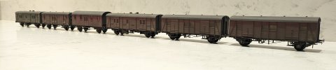

Well, these are mostly done now (I need tyre weights to ballast them, and some NEM couplings to go in the pockets) but painting, transfers are all finished. Shown here with two previous models. In all we have:
Stove BY S402S
CCT S1422S
P19 W563W
BY S762S
PMV S1972S
PMV S1995S
I'm looking forward to starting something new - these have been hanging around far too long! I have a Mink G I fancy having a go at.

Yes - everything was effectively in BR s**t brown livery really, especially the SR vans... If they are anything like this Van B, then only one colour paint is needed... https://paulbartlett.zenfolio.com/srguvandb/hFD3AAAF#hfd3aaaf . Can even do without the numbering/transfers!
I may have to get some more Railmatch Frame Dirt at this rate...
