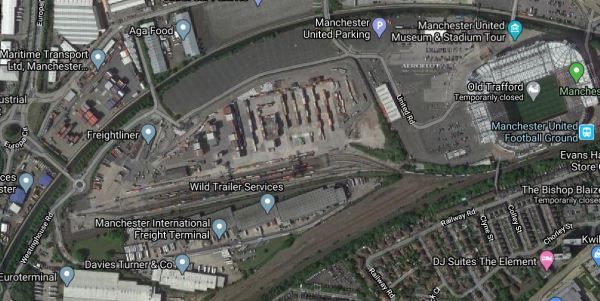

Further (regurgitated PR) details about the MUFC Old Trafford plans here:
21,902
Despite the fancy graphics released today, I can't work out where the footprint of the new stadium is, relative to what's there now.
It doesn't appear to be based on the current stadium.
If it requires railway land, the Trafford Park terminal would have to be moved before they can start construction.
That means approval for the new terminal sites, presumably at Port Salford and Parkside, will be needed first.
They won't be built in a hurry, so the start of stadium construction will be years away.
Unless there is a cunning plan...
They are claiming a 5 year build, but as you note with all the other interdependencies, consents and processes, its a decade away at best.
On the overview ‘shot’, I’d look at where it is compared to the canal. To me, the new stadium is essentially on top of the current freight terminal.
