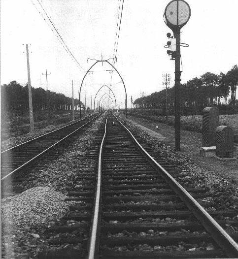

As for pushing the envelope, the state of the track after the French world rail speed record runs in 1955 (B-B electric loco + three carriages at 206 mph) tells you all you need to know about how close to the edge they were....
