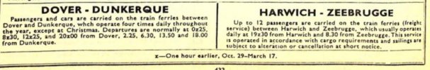

Here, courtesy of the Cooks Continental Timetable on the Timetable World website, is the timetable for the Dover-Dunkerque ships in summer 1974. There were actually four such crossings a day, only one taking the Night Ferry, the others combinations of road vehicles and freight wagons. Apparently a significant number of road vehicles on this route were export new cars, known to BR as "trade cars", driven on and off by railway staff.
The four trips each way used two vessels, passing en route. No more ships could be used because there was only one rail-connected ferry dock at each end. Presumably if a sailing was cancelled for any reason, the opposite sailing would have to be cancelled as well. The original 1930s train ferries were all retired by this time, I believe the two used were the SNCF Saint Germain and the BR Vortigern.
