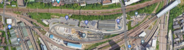

An underground Javelin station ... um ... where? Do you mean a new grade-separated junction in the tunnel in the run-in to StP, for domestic services to separate and then burrow down under the maze of KX/StP tunnels for a station somewhere down there, before using a freshly-bored tunnel under north London to go to ... my crayons are throbbing.
The place seemingly apparent is adjacent to the North London Line on Freight Lane where the Tarmac Concrete Plant is. Camden Accessible Travel Solutions have a depot there which could be expendable. Presumably the need for a concrete plant will diminish once construction in the area is complete.
[Screenshot shows exit from the HS1 route at Belle Isle and patch of land used for various purposes to the north of King's Cross - https://www.google.co.uk/maps/@51.5400881,-0.128926,717m/data=!3m1!1e3?entry=ttu]
Long way to walk to Kings Cross though.
[Screenshot shows exit from the HS1 route at Belle Isle and patch of land used for various purposes to the north of King's Cross.]
Aha - you might know that there's long been a local aspiration for an overground - these days, Overground - station on the NLL there, to be called Maiden Lane. So a KX Javelin station deep under the Overground as an integrated station... And of course it would only be a couple of hundred yards as the crow flies from the (long closed) York Road station in the Piccadilly Line underground, which locals have also said they want back one day... Maybe a new Kings Cross North station complex... (For the avoidance of doubt, my tongue is firmly in my cheek, and my crayons aren't out.)
