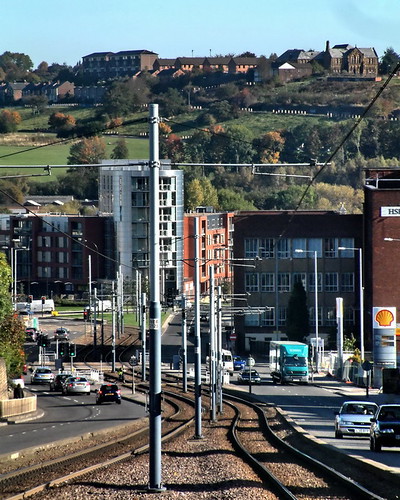

:?: Is this located on the steepest inclined section of (non-rack) railway/tramway track in the UK?

Its a 10% gradient I believe and the rest of the UK tramways have max 6% gradients.

Brilliant pictures :D
By the looks of it the track is in need of replacement soon in that area

It is some slope there, I am always glad there is a tram for getting back to the station :)

Looked it up, max gradient of Metrolink vehicles according to manufacturers are both 6.5% or roughly 1/15, Siemens-Duewag Supertram is 10% or 1/10.
Steepest spots on the Metrolink line at moment is probably the Eccles line between Pomona and Cornbrook with the Cornbrook ramp near Manchester Central a tiny bit less steep. Theres going to be some really tough slopes in a couple of spots on the new lines like where the South Manchester Line dives under the Altrincham line at Old Trafford, the ramp from the Queens Road Depot to the Oldham line viaduct and a few other spots.
