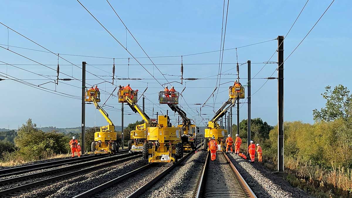

Good. Much better safety case for using MEWPs than ladders.
Exactly. Safety improvements all the time and incrementally
Certainly is, they can work independently on multiple headspan assemblies concurrently, over the best part of half a mile. Not all of the work was on adjacent headspans, those that I saw today were spread over a couple of miles.
Great flexibility
OK., and there's no one working off a 6m ladder!

Picture from yesterday should have been dated 2025, of course! Have amended. I wonder how much of the carpark was used to park these up after use!
By the way, the strange white object on a pole in the corner of our site contains the two 'Railcam' cameras - these can be accessed on the Railcam website but only by subscribers.
