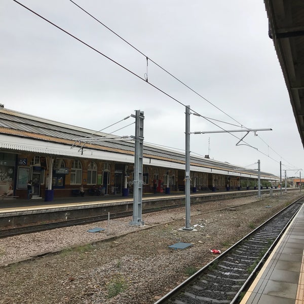

I wonder if electrification of the Up Fast and Down Fast at Leicester will be done in a similar fashion to how Bolton was done, with two single track cantilevers placed on each side, for platforms 2 and 3?
Picture shows electrification masts at Bolton station
I was back at Leicester this morning, the only pegs I could see were on the platform 2 side of that cable trough in my photo from yesterday, labelled '159 *** DF'. Maybe about 5 pegs along most of the length of the platform but didn't see any near to London Road bridge. It was dark though. No pegs along platform 4 but I guess the sidings are in the way there.
Would they be going to the effort of marking mast locations if piling works weren't on the cards soon?
