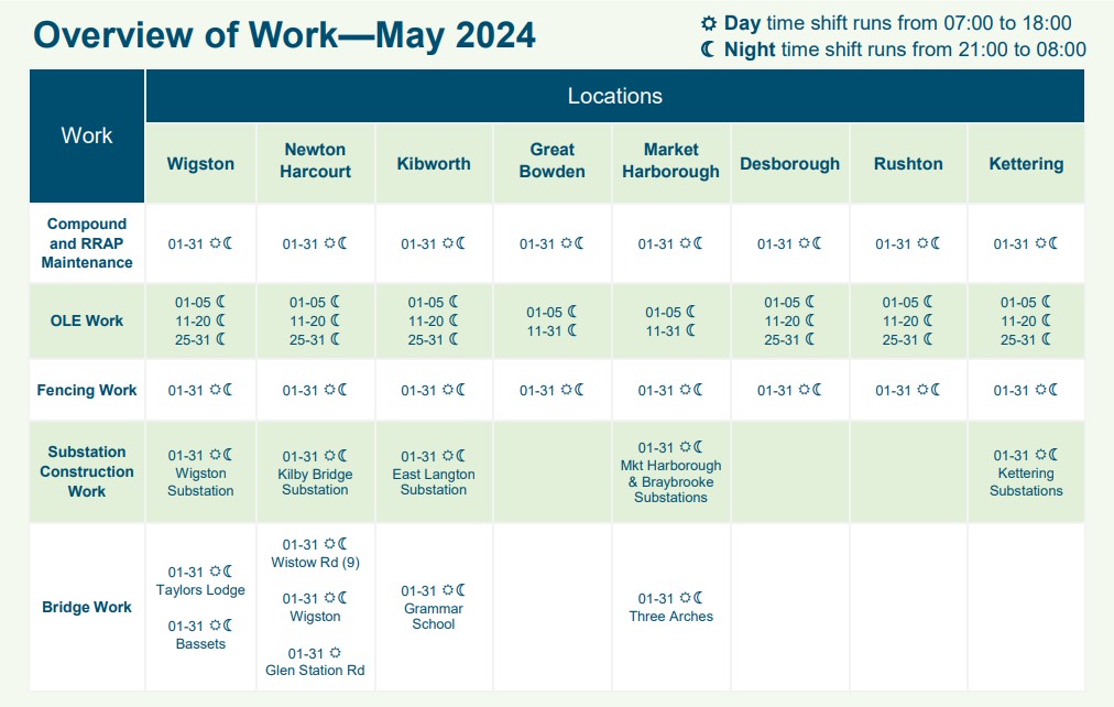

It looks as though an access road is under construction to Three Arches Bridge.
That's a fine picture - under-construction access road, rear-view mirror perspective and fully-modified Braybrooke GSP pylon in one shot!
I had a quick browse on RMweb and came across a picture of Wigston MPATS with the autotransformers in place (to the left of picture), so that's the substation side of K2W pretty much done now. The grey line from near the switchgear masts to beyond the distant signal gantry could be a short extension lead.
