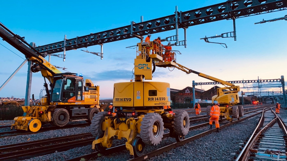

Here's a LinkedIn post on some of the Christmas engineering works south of Bedford - specifically the renewal of Grahame Park OHNS.
