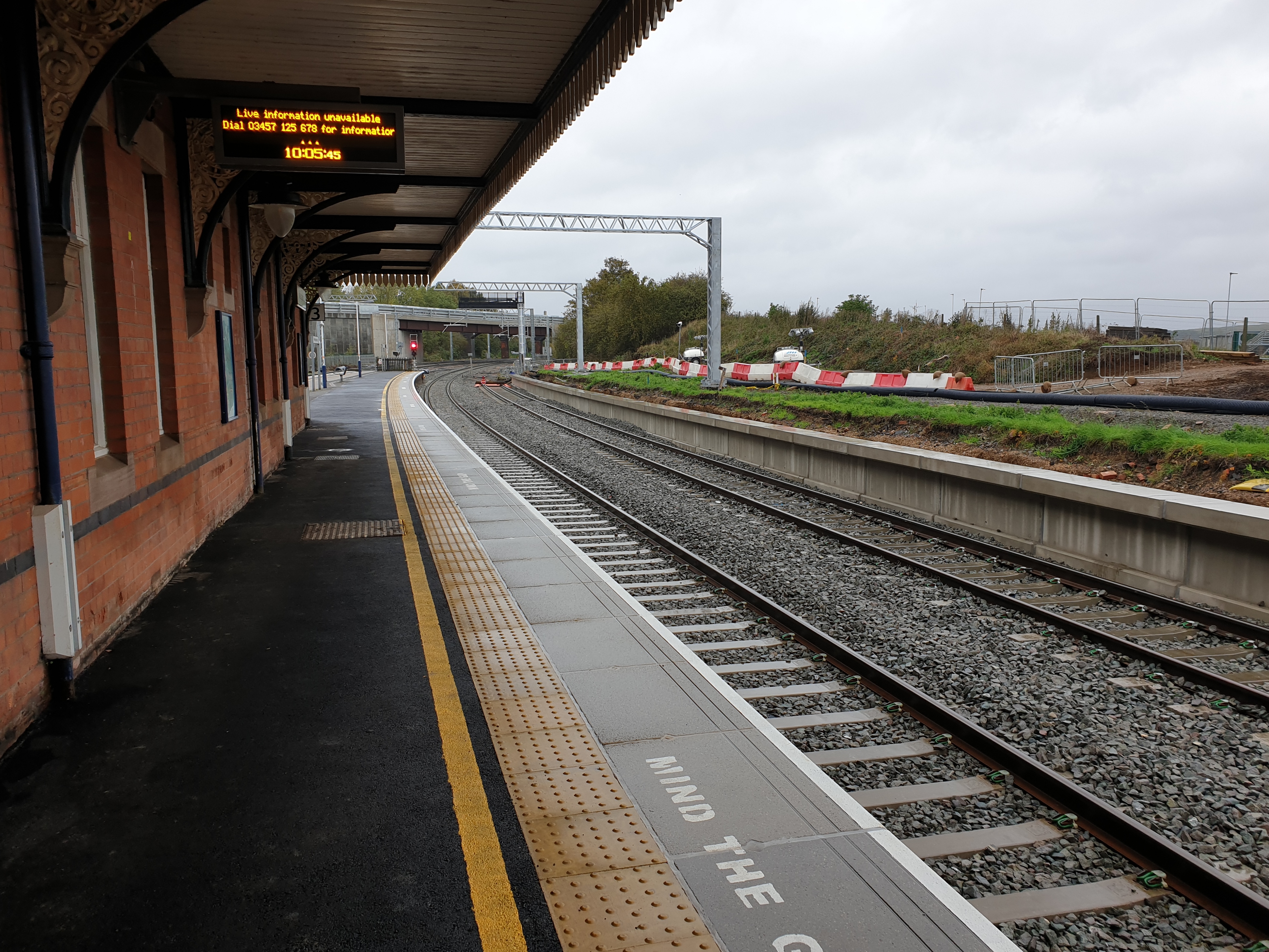

  • Preparations to return the 4th platform (P4) at Wellingborough to public use have now begun. Concrete facings for P4 are now appearing.
  • All masts but one are now up within Wellingborough Station; the outlier is a TTC on P2 which has led to the platform surface being excavated to install the foundations.
