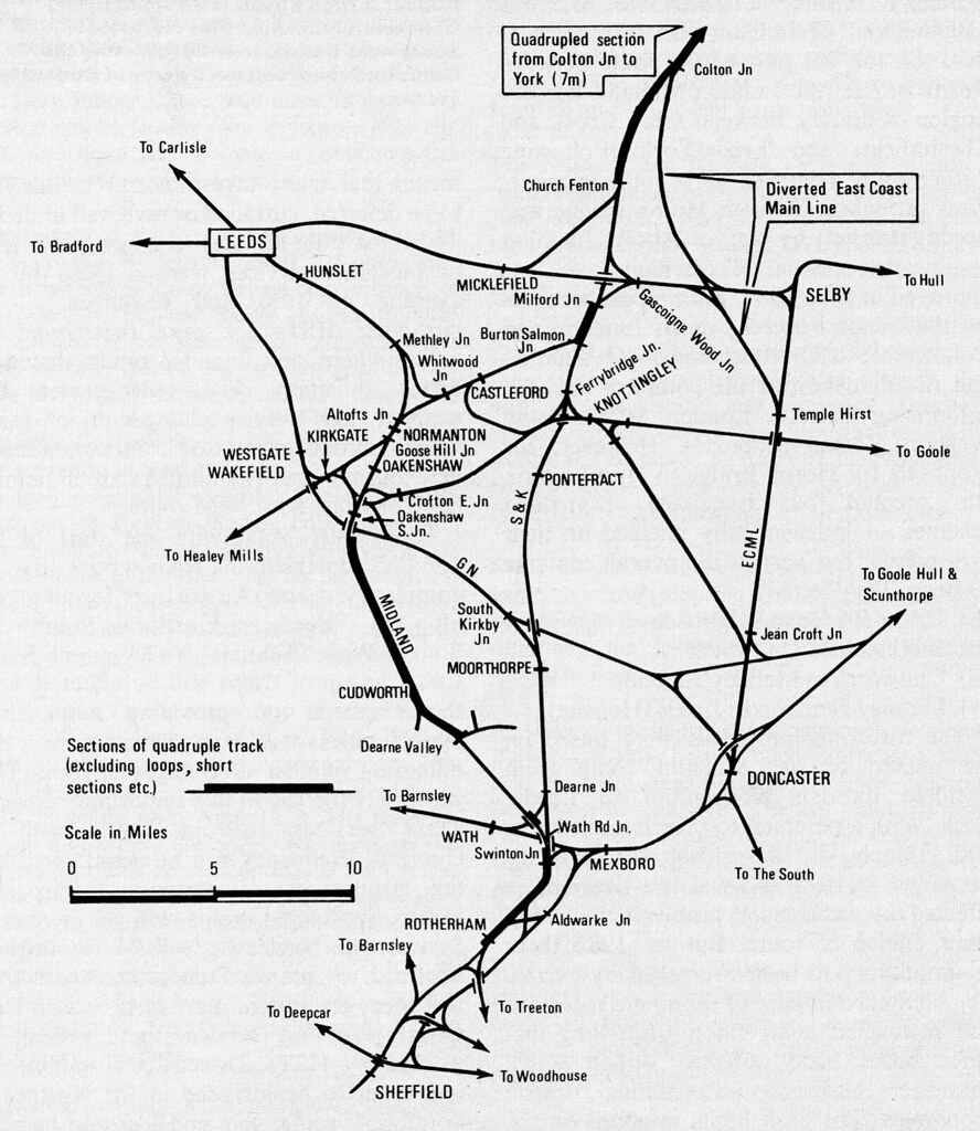

Brian Perren - Modern Railways - August 1983 said:
Sheffield-Leeds/York: re-routing in 1984
NEXT May, with the start of the 1984-85 timetable, the Eastern Region is to introduce new routeings for InterCity services between Sheffield and Leeds/York. Instead of running by way of the old Midland route from Swinton through Cudworth and Normanton to Altofts Junction thence Methley Junction (for services to/from Leeds) or Castleford (for services to/from York and beyond), Leeds trains will use the old Swinton and Knottingley (S&K) line to Moorthorpe where they will join the old Great Northern (GN) route through Wakefield (Westgate) and thence to Leeds, and trains to/from York and beyond will be rerouted to run by way of Mexborough to join the East Coast main line at Doncaster. There are a number of reasons for this interesting change. The two most important are the commercial benefits which will be obtained by Northeast-Southwest services calling at Doncaster, and investment and current financial savings to be achieved by reducing the two alternative passenger routes between Sheffield and Leeds to one.
To appreciate the background leading to the re-routeing decision it is necessary to go back to the original proposals for the Northeast-Southwest High Speed Train scheme, which was approved in June 1978. It will be recalled that the Department of Transport authorised the building of 18 HST sets and also approved - but only in principle - associated work on track and signalling costing £10.4million. Of this £10.4million, £2.6million was in respect of work on the ER part of the route between Horns Bridge (the London Midland/Eastern Region boundary between Clay Cross and Chesterfield) and Leeds/York. Following further study a detailed set of route improvement proposals between Horns Bridge and Leeds (Hunslet) by way of Altofts Junction - costing about £3.5million - was approved in June 1981, but proposals covering the section between Altofts Junction and Colton were deferred pending a re-evaluation and re-submission of the complete package comprising Eastern, London Midland and Western Region proposals. However, the proposals for Horns Bridge to Hunslet took into account four associated resignalling schemes - independently justified on their own merits, but part of the overall routeing strategy. They were:
(i) Horns Bridge to Brightside
(ii) Brightside to Cudworth
(iii) Cudworth to Methley Junction
(iv) Methley Junction to Leeds (Hunslet).
The foregoing proposals were based on the choice of the Midland route from Sheffield through Normanton to Leeds/ York. With a potential to raise line speeds to 100/115mph, it was ideal for primary passenger services and was less likely to be affected by subsidence problems than any other choice of route. But by 1982 these assumptions had been overtaken by events. The combined impact of economic recession and intensified competition from long distance buses badly affected British Rail's passenger business, necessitating drastic economies. The cash limits imposed on the British Railways Board by the Government meant that many investment proposals had to be deferred, curtailed or reviewed in depth. To adjust train services to a new lower level of business, services were reduced by an average of 10% and resources - in particular HSTs - were redeployed on routes where their financial return would be better. In many cases redeployment has enabled train service changes to be made which introduced revised routeings offering new journey opportunities. A case in point is the Northeast-Southwest route.
From next May, with the start of the 1984-85 timetable, the train service is to be completely recast. All services forming part of the Northeast/Northwest-Southwest/ South Wales/Thames Valley and South Coast group of trains will be affected, with the emphasis on providing new travel opportunities over long distances with the minimum number of changes of train. This will affect the ER in two important respects. Train services to/from Leeds will be changed. Frequency will be maintained, but the proportion of services formed by locomotive-hauled trains will be increased. Services to Newcastle will be rerouted at Sheffield to run via Doncaster, where they will form an integral part of a revised East Coast main line service; these will all be worked by HSTs. Doncaster is sufficiently important to be included in the Northeast-Southwest route, but considerable benefits will follow from integration with the East Coast main line HSTs. Between Doncaster and Newcastle Northeast-Southwest services will supplement East Coast trains and Doncaster will grow in importance as an interchange station. King's Cross-York semifasts will terminate at Doncaster, which will save train mileage. While the distance from Sheffield to York via Doncaster is 4½ miles longer than via Castleford, the journey time - including the Doncaster stop - is about the same. With the Selby Diversion fully operational at full line speeds by next May, HSTs will be able to run at 125mph for almost the whole distance from Doncaster to York.
Given this new situation the case for upgrading the Midland route from Sheffield to York no longer exists and trains to/from Leeds can be accommodated on the S&K as far as Moorthorpe, where they will diverge to join the Doncaster-Leeds line at South Kirkby Junction and will also serve Wakefield.
Track and resignalling improvement plans revised
Given the rerouteing decision all plans for trackwork and resignalling had to be revamped. Because of the way the various engineering proposals have been evaluated and submitted for approval - and as the geography of the area is itself complicated - it is preferable to describe previous and revised proposals together on a sector-by-sector basis.
Horns Bridge to Swinton Junction
Strictly speaking the major part of this section - the 13 miles between Horns Bridge and Sheffield Midland station - is not part of the re-routeing plans. However, it is an important part of the overall plan for upgrading the Northeast-Southwest route and the line speed will be raised to 90-95mph, apart from the restriction to 60mph at Dore. In passing one should note that this upgrading was originally justified for Northeast-Southwest HSTs, before the decision to use HSTs on the Midland route between St Pancras and Sheffield was made - but now Midland HSTs will of course also benefit. North of Sheffield Midland station work has not yet started, but the line speed will be raised to 100 mph where this is possible.
Swinton Junction to Moorthorpe
At present line speed on the S&K route between Swinton Junction and Moorthorpe is 75mph. The condition of track, general alignment and braking distance limitations imposed by the signalling are such that a number of works are necessary to raise the line speed to a desired level of 100 mph for HSTs. The approximate cost of the work is £524,000. Another restriction is that trains using the S&K route have to use the slow line between Aldwarke and Swinton, necessitating passage of 25mph crossovers to/from the fast lines at Sheffield Aldwarke Junction. Trackwork proposals include slewing the up and down Midland tracks between Swinton Junction and the old Wath Road Junction into the S&K lines. The speed through the slew will be 80 mph; as a result of the rerouteing proposals the route to/from Cudworth can be proposed for closure and, if approved, severed. At a number of locations between the new slew at Wath Road Junction and Moorthorpe, the route will be realigned for 100 mph. Existing signalling - which includes the last remaining pocket of semaphore signalling between Bristol and Leeds - will be replaced by multiple-aspect signalling giving adequate braking distances for HSTs running at 1OO mph and for locomotive-hauled trains running at 85mph. 100 mph braking distances for all trains is not thought to be financially justifiable.
Moorthorpe to Leeds
Separate plans for line speed improvements on the GN Doncaster-Leeds section are under study, but have yet to be approved. There is a potential for line speed improvements between South Kirkby Junction and Leeds which would reduce journey times over this section by four minutes, benefiting HST services to/from both the Southwest and King's Cross. The ER is at present examining the justification for the expenditure involved.
Aldwarke Junction-Mexborough East
Although Sheffield-York HSTs rerouted via Doncaster will - despite the additional distance and the Doncaster stop - take approximately the same time as now, all the time is gained on the East Coast main line between York and Doncaster. The section of route between Sheffield and Doncaster is severely restricted and a number of line speed improvements are necessary. Coming out of Sheffield on the Midland tracks, trains for Doncaster also have to pass over the 25mph crossing at Aldwarke Junction on to the old Great Central (GC) line. For the next three miles to Mexborough East line speed is only 50 mph, reduced to 15mph for passage of the Mexborough East-South curve. However, the junction at Aldwarke will soon be due for renewal and could be simplified giving a higher line speed; Mexborough East-South curve is also due for renewal and could be realigned raising the speed from 15 to 60mph. There is an alternative option: reinstatement of the curve between Swinton and Mexborough. This would require Parliamentary Powers, but would have two advantages. HSTs - plus the Sheffield-Doncaster local services - would use the potentially faster Midland tracks for a greater distance, and it would be possible to simplify the layout at Aldwarke and rationalise the GC route from there to Mexborough- East. These options are being studied. The South Yorkshire Passenger Transport Executive will be concerned with this proposal, as it supports the Sheffield-Doncaster local service and is studying a separate proposal to fund a new chord line linking the Midland and GC lines at Rotherham Holmes and to reopen Rotherham Central station.
Mexborough East-Doncaster
Line speed between Mexborough East and St James Junction, just outside Doncaster station, is at present 50 mph. With programmed renewals the condition of the track and alignment will be progressively improved enabling the speed to be raised to 70mph, except for the passage of Conisbrough Tunnel where clearances impose a limit of 50 mph. Existing signalling is suitable for the higher speeds. Physical constraints preclude further improvements at a reasonable level of costs. The new line speed will apply from May 1984.
There are some potential problems at Doncaster. The approach to/exit from the Sheffield line into/out of Doncaster station is through a ¾ mile single line restricted to 25mph. For the present the timetable will have to accept this constraint, but if East Coast electrification is approved a number of bridges in the area will have to be modified and this short bottleneck could then be doubled. Another problem is No 3 (up side) platform at Doncaster. Because of its limited length in the rear of the junction to Sheffield, it is not possible to use this for an HST routed to Sheffield. HSTs both to/from the Sheffield line will have to use the down island platform (Nos 4 and 8), but this is unlikely to be a particular problem. Doncaster station layout is signalled for such movements. Again, if there are any potential timing conflicts, the timetable will have to be adjusted.
This interesting package of proposals once again shows the changing pace of business development on BR and how parts of the network previously considered of secondary importance can be brought back into front line service.
