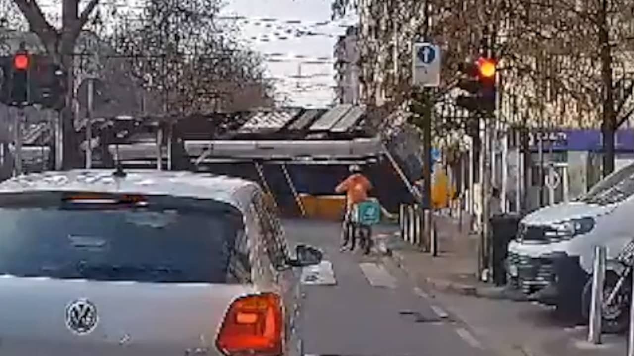

The derailment happened at this intersection where line 9 should continue straight ahead, but instead turned left at high speed according to this dashcam-video:
